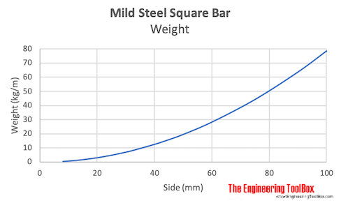

Typical weights of mild steel square bars.
Weight of mild steel square bars can be calculated as
W = 0.00785 s2                                  (1)
W = weight (kg/m)
s = square bar side (mm)
Mild Steel - Square Bars Weight
Bar Side
(mm)
Weight
(kg/m)
8 0.50
10 0.79
12.5 1.22
16 2.01
20 3.14
25 4.91
30 7.07
32 8.04
40 12.6
45 15.9
50 19.6
60 28.3
75 44.2
90 63.6
100 78.5
Mild steel square bar - weight
