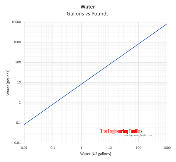

Convert Gallons of Water to Pounds
w = 8.33 q                  (1)
w = weight of water (lb)
q = volume of water (US gallons)
The equation is based on water with temperature 68 oF (20 oC) and specific weight 8.33 lb/US gal.
Example - Converting Gallons of Water to Pounds
50 gallons of water can be converted to pounds as
w = 8.33 (50 gallons)
   = 416.5 lb
Convert Pounds of Water into Gallons
q = w / 8.33                     (1b)
Water - gallons vs. pounds
Download and print Water - Gallons vs. Pounds chart
