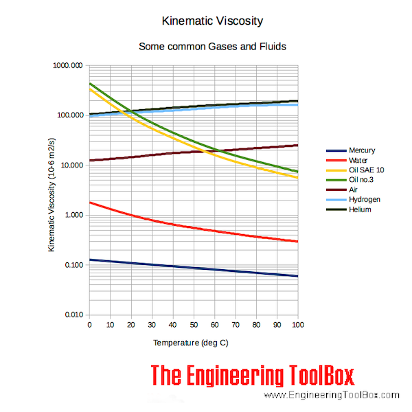

Viscosity and Temperature
Kinematic viscosity of fluids like water, mercury, oils SAE 10 and oil no. 3 - and gases like air, hydrogen and helium are indicated in the diagram below. Note that
  • for liquids - viscosity decreases with temperature
  • for gases - viscosity increases with temperature
Kinematic viscosity vs. temperature for some common fluids and gases
