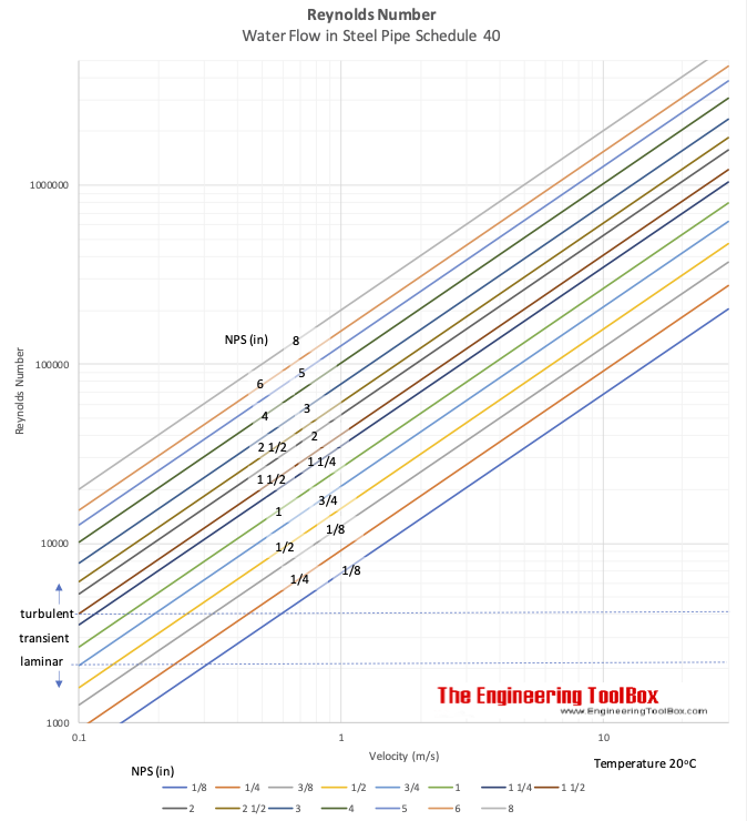

Default values are for water at 20 oC with kinematic viscosity 1.004×10-6 m2/s in a schedule 40 steel pipe . The characteristic length (or hydraulic diameter) of the pipe is 0.102 m.
Reynolds number chart water flow schedule 40 steel pipe
