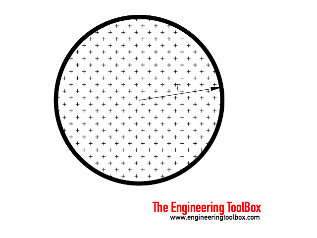

Hydraulic Diameter of a Circular Tube or Duct
Circular tubes and pipes - hydraulic diameter
Based on equation (1) the hydraulic diameter of a circular duct can be expressed as:
dh = 4 π r2 / (2 π r)
    = 2 r
    = d                                  (2)
r = pipe or duct inside radius  (m, ft)
d = pipe or duct inside diameter  (m, ft)
As we could expect the hydraulic diameter of a standard circular tube or duct is the inner diameter or two times the inner radius.

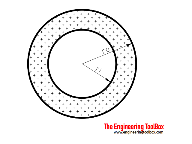

Hydraulic Diameter of Circular Tube with Circular Tube on the Inside
The flow is in the volume between the inside and outside pipe.
Hydraulic Diameter of circular tube with inside circular tube
Based on equation (1) the hydraulic diameter of a circular duct or tube with an inside duct or tube can be expressed as
dh = 4 (π ro2 -π ri2) / (2 π ro + 2 π ri)
    = 2 (ro - ri)                                        (3)
ro = inside radius of the outside tube (m, ft)
ri = outside radius of the inside tube (m, ft)

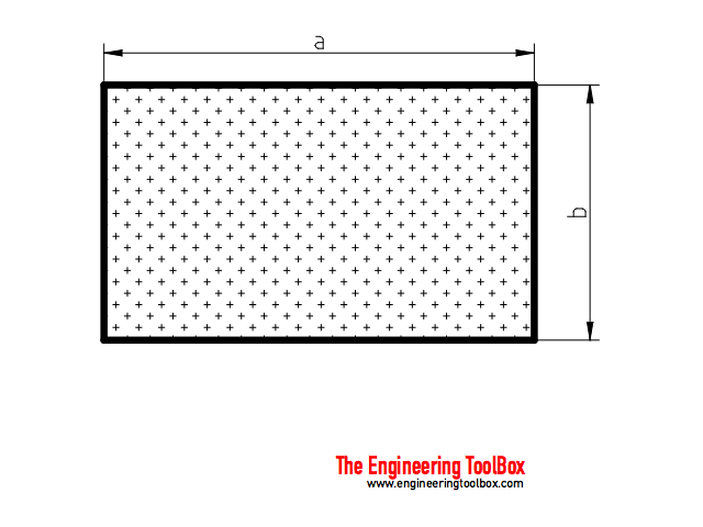

Hydraulic Diameter of Rectangular Tubes or Ducts
Hydraulic Diameter of rectangular tube or duct
Based on equation (1) the hydraulic diameter of a rectangular duct or pipe can be calculated as
dh= 4 a b / (2 (a + b))
    = 2 a b / (a + b)                                 (4)
a = width/height of the duct (m, ft)
b = height/width of the duct (m, ft)

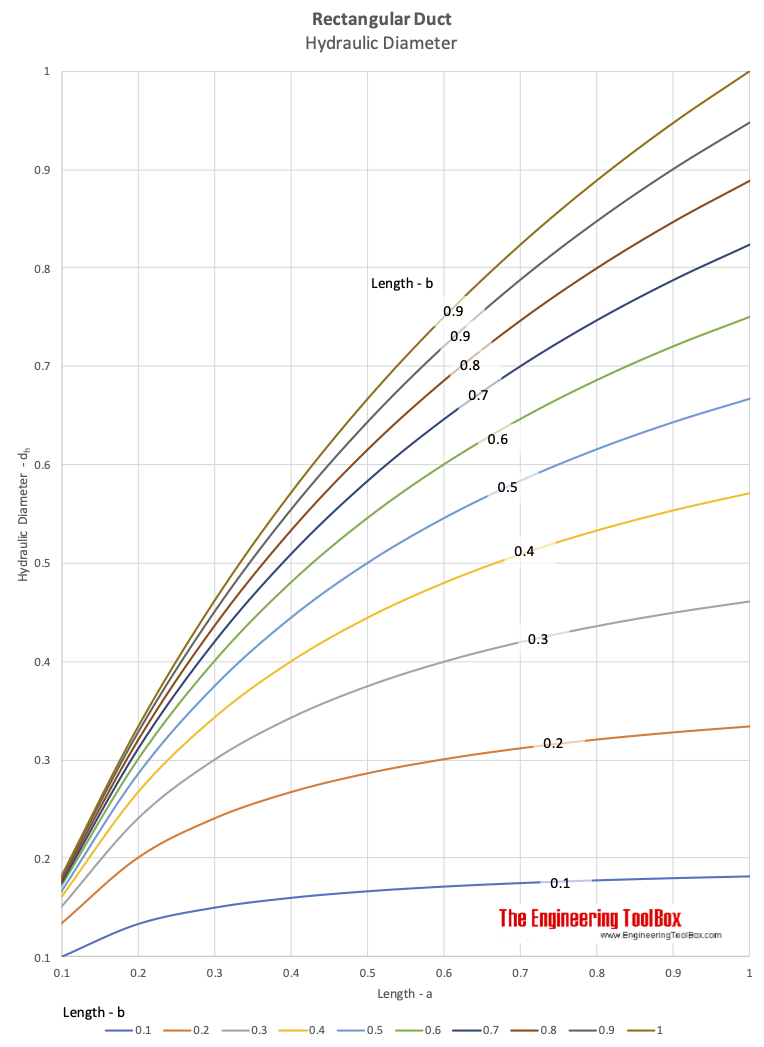

The calculator below is based on formula (4) an can be used to calculate the hydraulic diameter of rectangular duct or tube. The formula is generic and any unit can be used.
Rectangular ducts, tubes or pipes - hydraulic diameter diagram
