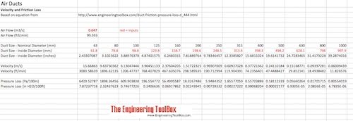

Air Ducts - Velocity and Friction Loss - Excel Template
This Excel template can be used to calculate velocity and friction loss in air ducts.

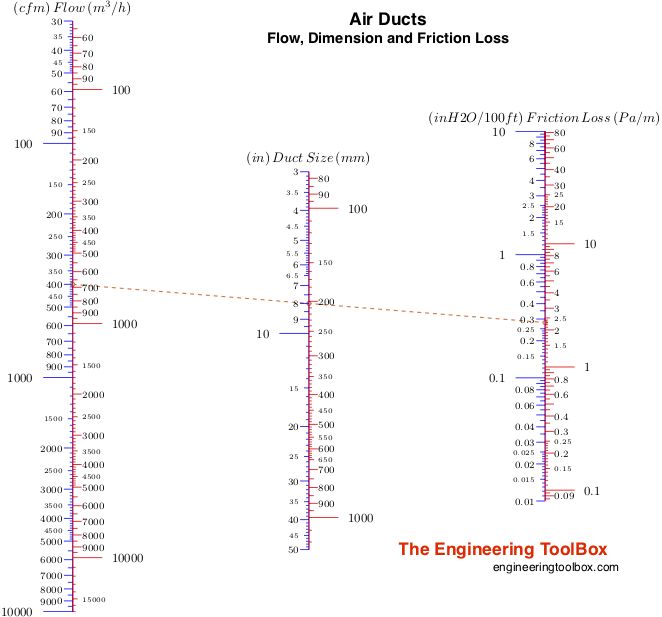

Air Ducts - Friction Loss Diagram
The chart below can be used to estimate friction loss in air ducts.
The default values are for air flow 400 cfm (680 m3/h) , duct size 8 in (200 mm) and friction loss 0.28 inH2O/100ft (2.3 Pa/m) .
Download and print Air Ducts Friction Loss Diagram!
