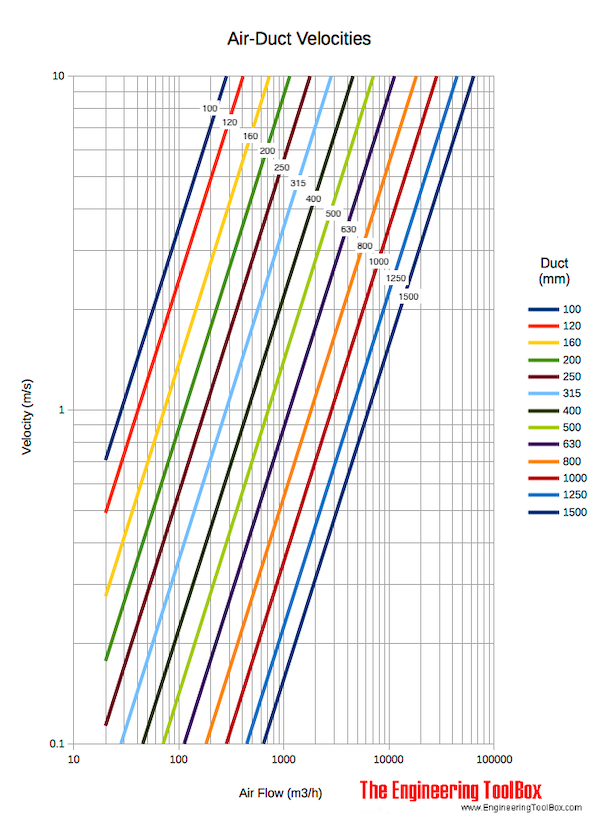

Sizing Ducts
Sizes of ducts are then given by the continuity equation like:
A = q / v                                      (1)
A = duct cross sectional area (m2)
q = air flow rate (m3/s)
v= air speed (m/s)

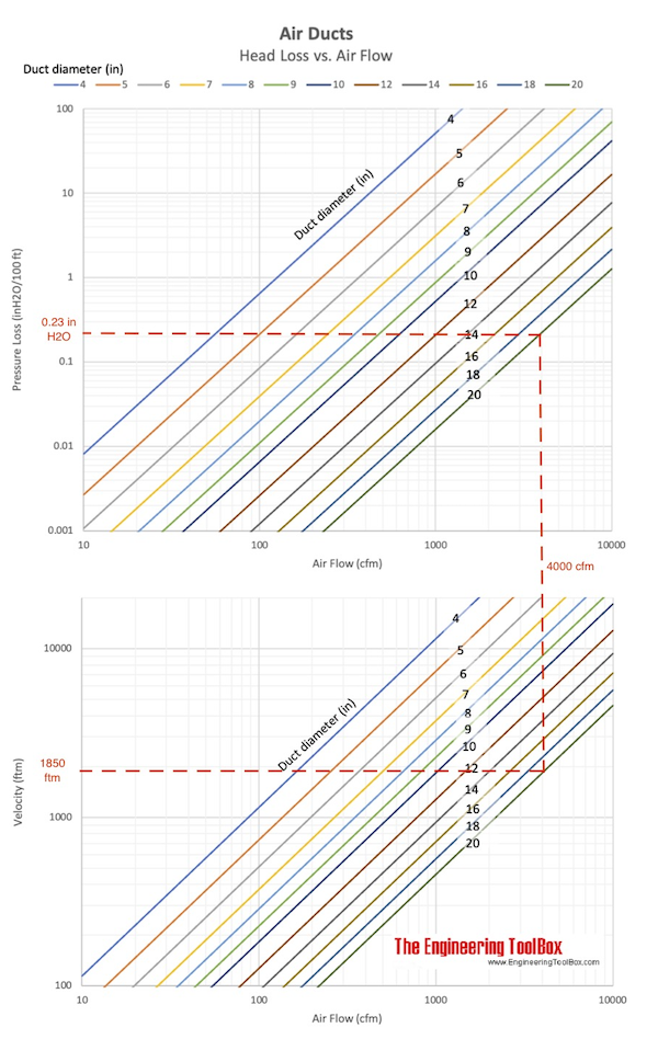

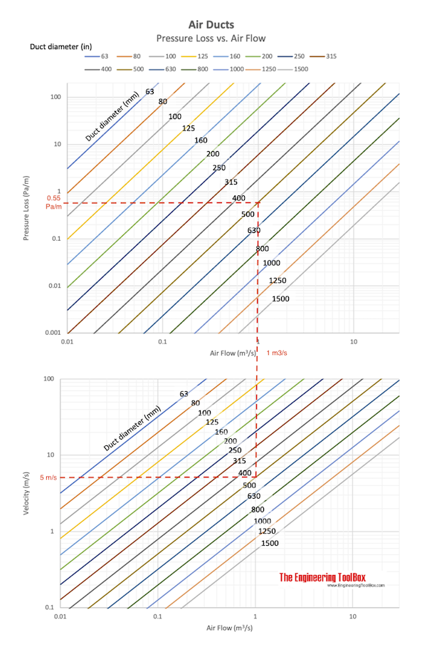

Frictional Pressure Loss
Estimate friction loss in main and branch ducts from the charts below:
Air Ducts Friction loss - Imperial units
Air Ducts - friction loss - SI units

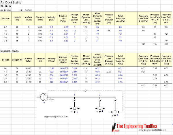

Air Ducts Sizing Spreadsheet Template
Air Ducts Spreadsheet Template - The Velocity Method
The velocity method can be done manual or more or less semi automatic with the spreadsheet template below.
Air Duct Sizing
open air duct sizing spreadsheet!
This template is based on the in the spreadsheet. Customize sections, airflows, duct sizes and minor dynamic loss coefficients - add pressure loss paths and evaluate and reconfigure the system to fit your criteria. Summarize pressure loss for each path and add damper pressure losses manually to balance the system.
The Google Docs spreadsheet template can be opened and copied here! The spreadsheet can also be downloaded as an excel file. Use the Google Docs "File" menu on the top of the template.
