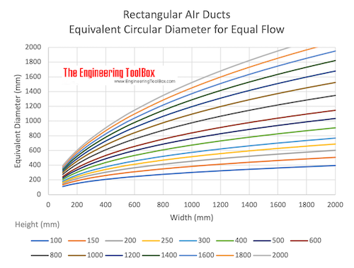

Equivalent diameters for some common mm rectangular duct dimensions:
For full table with larger dimensions - rotate the screen!
Circular equivalent diameter - de (mm)
Duct
side
- a -
(mm)
Duct side - b (mm)
100 150 200 250 300 400 500 600 800 1000 1200 1400 1600 1800 2000
100 109 133 152 168 183 207 227
150 133 164 189 210 229 261 287 310
200 152 189 219 244 266 305 337 365
250 168 210 246 273 299 343 381 414 470
300 183 229 266 299 328 378 420 457 520 574
400 207 260 305 343 378 437 488 531 609 674 731
500 227 287 337 381 420 488 547 598 687 762 827 886
600 310 365 414 457 531 598 656 755 840 914 980 1041
800 414 470 520 609 687 755 875 976 1066 1146 1219 1286
1000 517 574 674 762 840 976 1093 1196 1289 1373 1451 1523
1200 620 731 827 914 1066 1196 1312 1416 1511 1598 1680
1400 781 886 980 1146 1289 1416 1530 1635 1732 1822
1600 939 1041 1219 1373 1511 1635 1749 1854 1952
1800 1096 1286 1451 1598 1732 1854 1968 2073
2000 1523 1680 1822 1952 2073 2186

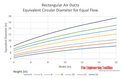

rectangular air ducts - equivalent diameters for equal flow - mm
print equivalent diameter diagram!
Equivalent diameters of some common inches rectangular ducts:
Circular equivalent diameter (inches)
Length
- b -
(inches)
Length - a - (inches)
4 5 6 8 10 12 16
4 4.4 4.9 5.3 6.1
5 4.9 5.5 6 6.9 7.6
6 5.3 6 6.6 7.6 8.4 9.1
8 6.1 6.9 7.6 8.6 9.8 10.7 12.2
10 7.6 8.4 9.8 10.9 12 13.7
12 9.1 10.7 12 13.1 15.1
16 12.2 13.7 15.1 17.5
rectangular air ducts - equivalent diameters for equal flow - inches
