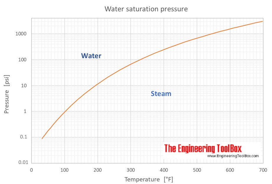

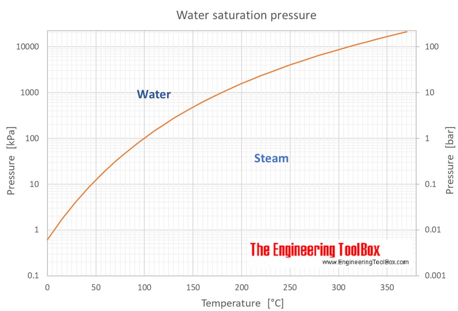

The saturation pressure of water depends on temperature as shown below:

Saturation pressure at temperatures given in degree Celcius and pressure given in kiloPascals (kPa), bars, atmospheres (atm) and pounds per square inch (psi):
| Temperature | Water saturation pressure | ||
| (°C) | (kPa), (100*bar) | (atm) | (psi) |
| 0.01 | 0.61165 | 0.0060 | 0.088712 |
| 2 | 0.70599 | 0.0070 | 0.10240 |
| 4 | 0.81355 | 0.0080 | 0.11800 |
| 10 | 1.2282 | 0.0121 | 0.17814 |
| 14 | 1.5990 | 0.0158 | 0.23192 |
| 18 | 2.0647 | 0.0204 | 0.29946 |
| 20 | 2.3393 | 0.0231 | 0.33929 |
| 25 | 3.1699 | 0.0313 | 0.45976 |
| 30 | 4.2470 | 0.0419 | 0.61598 |
| 34 | 5.3251 | 0.0526 | 0.77234 |
| 40 | 7.3849 | 0.0729 | 1.0711 |
| 44 | 9.1124 | 0.0899 | 1.3216 |
| 50 | 12.352 | 0.122 | 1.7915 |
| 54 | 15.022 | 0.148 | 2.1788 |
| 60 | 19.946 | 0.197 | 2.8929 |
| 70 | 31.201 | 0.308 | 4.5253 |
| 80 | 47.414 | 0.468 | 6.8768 |
| 90 | 70.182 | 0.693 | 10.179 |
| 96 | 87.771 | 0.866 | 12.730 |
| 100 | 101.42 | 1.001 | 14.710 |
| 110 | 143.38 | 1.42 | 20.796 |
| 120 | 198.67 | 1.96 | 28.815 |
| 130 | 270.28 | 2.67 | 39.201 |
| 140 | 361.54 | 3.57 | 52.437 |
| 150 | 476.16 | 4.70 | 69.061 |
| 160 | 618.23 | 6.10 | 89.667 |
| 180 | 1002.8 | 9.90 | 145.44 |
| 200 | 1554.9 | 15.35 | 225.52 |
| 220 | 2319.6 | 22.89 | 336.43 |
| 240 | 3346.9 | 33.03 | 485.43 |
| 260 | 4692.3 | 46.31 | 680.56 |
| 280 | 6416.6 | 63.33 | 930.65 |
| 300 | 8587.9 | 84.76 | 1245.6 |
| 320 | 11284 | 111.4 | 1636.6 |
| 340 | 14601 | 144.1 | 2117.7 |
| 360 | 18666 | 184.2 | 2707.3 |
| 370 | 21044 | 207.7 | 3052.2 |
Saturation pressure at temperatures given in degree Fahrenheit and pressure given in pounds per square inch (psi), pounds per square foot (psf), kiloPascals (kPa) and bars:
| (°F) | (psi) | (psf) | (kPa), (100*bar) |
| 32.02 | 0.088712 | 12.775 | 0.612 |
| 34 | 0.09624 | 13.858 | 0.664 |
| 39.2 | 0.11800 | 16.991 | 0.814 |
| 40 | 0.12170 | 17.524 | 0.839 |
| 50 | 0.17814 | 25.651 | 1.228 |
| 60 | 0.25633 | 36.912 | 1.767 |
| 70 | 0.36341 | 52.330 | 2.506 |
| 80 | 0.50759 | 73.092 | 3.500 |
| 90 | 0.69915 | 100.7 | 4.821 |
| 100 | 0.95055 | 136.9 | 6.554 |
| 110 | 1.2766 | 183.8 | 8.802 |
| 120 | 1.6949 | 244.1 | 11.686 |
| 130 | 2.2258 | 320.5 | 15.347 |
| 140 | 2.8929 | 416.6 | 19.946 |
| 150 | 3.7232 | 536.1 | 25.671 |
| 160 | 4.7474 | 683.6 | 32.732 |
| 170 | 5.9999 | 864.0 | 41.368 |
| 180 | 7.5196 | 1083 | 51.846 |
| 190 | 9.3495 | 1346 | 64.462 |
| 200 | 11.537 | 1661 | 79.547 |
| 212 | 14.710 | 2118 | 101.42 |
| 220 | 17.203 | 2477 | 118.6 |
| 240 | 25.001 | 3600 | 172.4 |
| 260 | 35.263 | 5078 | 243.1 |
| 280 | 49.286 | 7097 | 339.8 |
| 300 | 67.264 | 9686 | 463.8 |
| 350 | 134.73 | 19402 | 929.0 |
| 400 | 247.01 | 35570 | 1703.1 |
| 450 | 422.32 | 60814 | 2911.8 |
| 500 | 680.56 | 98001 | 4692.3 |
| 550 | 1045.0 | 150485 | 7205.3 |
| 600 | 1542.1 | 222066 | 10632.6 |
| 625 | 1851.2 | 266570 | 12763 |
| 650 | 2207.8 | 317922 | 15222 |
| 675 | 2618.7 | 377092 | 18055 |
| 700 | 3092.0 | 445243 | 21318 |
