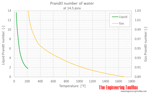

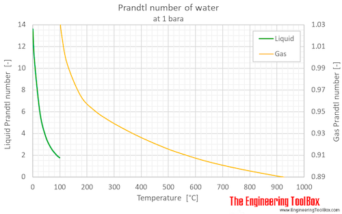

Prandtl number of water at 1 bara pressure, varying temperature given as °C or °F:

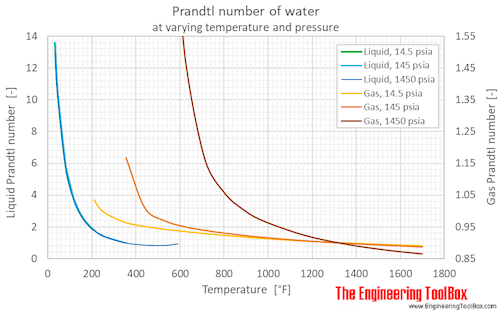

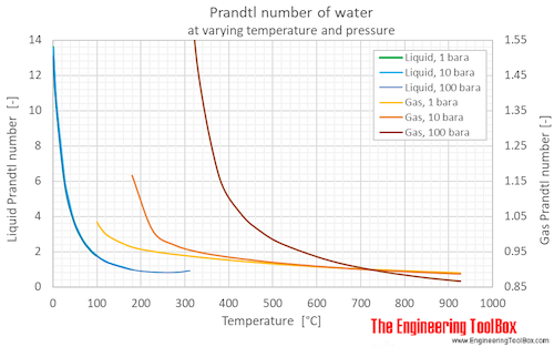

Prandtl number of water at 1, 10 and 100 bara (14.5, 145 and 1450 psia), varying temperature given as °C or °F:
Prandtl number of water at atmospheric pressure, temperature given as K, °C or °F:
| State | Temperature | Prandtl number | Temperature | Prandtl number | |||
| (K) | (°C) | (-) | (K) | (°F) | (-) | ||
| Liquid | 273 | 0 | 13.6 | 273 | 32 | 13.6 | |
| 278 | 5 | 11.2 | 278 | 40 | 11.5 | ||
| 283 | 10 | 9.46 | 283 | 50 | 9.46 | ||
| 293 | 20 | 6.99 | 297 | 75 | 6.31 | ||
| 298 | 25 | 6.13 | 311 | 100 | 4.56 | ||
| 303 | 30 | 5.43 | 325 | 125 | 3.45 | ||
| 323 | 50 | 3.56 | 339 | 150 | 2.74 | ||
| 348 | 75 | 2.39 | 353 | 175 | 2.25 | ||
| 373 | 100 | 1.76 | 366 | 200 | 1.88 | ||
| Gas | 373 | 100 | 1.03 | 394 | 250 | 0.999 | |
| 398 | 125 | 0.996 | 422 | 300 | 0.978 | ||
| 423 | 150 | 0.978 | 450 | 350 | 0.964 | ||
| 448 | 175 | 0.965 | 478 | 400 | 0.970 | ||
| 473 | 200 | 0.958 | 533 | 500 | 0.945 | ||
| 523 | 250 | 0.947 | 589 | 600 | 0.937 | ||
| 573 | 300 | 0.939 | 644 | 700 | 0.930 | ||
| 623 | 350 | 0.932 | 700 | 800 | 0.923 | ||
| 673 | 400 | 0.926 | 755 | 900 | 0.917 | ||
| 773 | 500 | 0.916 | 811 | 1000 | 0.912 | ||
Prandtl number of water at given temperatures and 1, 10 and 100 bara (14.5, 145 and 1450 psia):
| State | Temperature | Pressure | Prandtl number | |||
| (K) | (°C) | (°F) | (bara) | (psia) | (-) | |
| Liquid | 273.16 | 0.01 | 32.02 | 1 | 14.5 | 13.60 |
| 280 | 6.9 | 44.3 | 1 | 14.5 | 10.53 | |
| 300 | 26.9 | 80.3 | 1 | 14.5 | 5.856 | |
| 320 | 46.9 | 116 | 1 | 14.5 | 3.785 | |
| 340 | 66.9 | 152 | 1 | 14.5 | 2.687 | |
| 360 | 86.9 | 188 | 1 | 14.5 | 2.040 | |
| 372.756 | 99.61 | 211.3 | 1 | 14.5 | 1.760 | |
| Gas | 372.756 | 99.61 | 211.3 | 1 | 14.5 | 1.035 |
| 380 | 107 | 224 | 1 | 14.5 | 1.020 | |
| 400 | 127 | 260 | 1 | 14.5 | 0.9938 | |
| 450 | 177 | 350 | 1 | 14.5 | 0.9644 | |
| 500 | 227 | 440 | 1 | 14.5 | 0.9512 | |
| 550 | 277 | 530 | 1 | 14.5 | 0.9425 | |
| 600 | 327 | 620 | 1 | 14.5 | 0.9354 | |
| 650 | 377 | 710 | 1 | 14.5 | 0.9289 | |
| 700 | 427 | 800 | 1 | 14.5 | 0.9231 | |
| 750 | 477 | 890 | 1 | 14.5 | 0.9179 | |
| 800 | 527 | 980 | 1 | 14.5 | 0.9132 | |
| 900 | 627 | 1160 | 1 | 14.5 | 0.9053 | |
| 1000 | 727 | 1340 | 1 | 14.5 | 0.8992 | |
| 1100 | 827 | 1520 | 1 | 14.5 | 0.8942 | |
| 1200 | 927 | 1700 | 1 | 14.5 | 0.8897 | |
| Liquid | 273.16 | 0.01 | 32.02 | 10 | 145 | 13.55 |
| 280 | 6.9 | 44.3 | 10 | 145 | 10.50 | |
| 300 | 26.9 | 80.3 | 10 | 145 | 5.847 | |
| 320 | 46.9 | 116 | 10 | 145 | 3.781 | |
| 340 | 66.9 | 152 | 10 | 145 | 2.685 | |
| 360 | 86.9 | 188 | 10 | 145 | 2.040 | |
| 380 | 107 | 224 | 10 | 145 | 1.632 | |
| 400 | 127 | 260 | 10 | 145 | 1.362 | |
| 450 | 177 | 350 | 10 | 145 | 1.000 | |
| 453.028 | 179.9 | 355.8 | 10 | 145 | 0.9873 | |
| Gas | 453.028 | 179.9 | 355.8 | 10 | 145 | 1.167 |
| 500 | 227 | 440 | 10 | 145 | 1.010 | |
| 550 | 277 | 530 | 10 | 145 | 0.9694 | |
| 600 | 327 | 620 | 10 | 145 | 0.9509 | |
| 650 | 377 | 710 | 10 | 145 | 0.9395 | |
| 700 | 427 | 800 | 10 | 145 | 0.9308 | |
| 750 | 477 | 890 | 10 | 145 | 0.9235 | |
| 800 | 527 | 980 | 10 | 145 | 0.9173 | |
| 900 | 627 | 1160 | 10 | 145 | 0.9069 | |
| 1000 | 727 | 1340 | 10 | 145 | 0.8990 | |
| 1100 | 827 | 1520 | 10 | 145 | 0.8928 | |
| 1200 | 927 | 1700 | 10 | 145 | 0.8875 | |
| Liquid | 273.16 | 0.01 | 32.018 | 100 | 1450 | 13.12 |
| 280 | 6.9 | 44.3 | 100 | 1450 | 10.23 | |
| 300 | 26.9 | 80.3 | 100 | 1450 | 5.761 | |
| 320 | 46.9 | 116 | 100 | 1450 | 3.746 | |
| 340 | 66.9 | 152 | 100 | 1450 | 2.669 | |
| 360 | 86.9 | 188 | 100 | 1450 | 2.030 | |
| 380 | 107 | 224 | 100 | 1450 | 1.626 | |
| 400 | 127 | 260 | 100 | 1450 | 1.358 | |
| 450 | 177 | 350 | 100 | 1450 | 0.9967 | |
| 500 | 227 | 440 | 100 | 1450 | 0.8531 | |
| 550 | 277 | 530 | 100 | 1450 | 0.8366 | |
| 584.147 | 311.00 | 591.79 | 100 | 1450 | 0.9349 | |
| Gas | 584.147 | 311.00 | 591.79 | 100 | 1450 | 1.841 |
| 600 | 327 | 620 | 100 | 1450 | 1.494 | |
| 650 | 377 | 710 | 100 | 1450 | 1.168 | |
| 700 | 427 | 800 | 100 | 1450 | 1.058 | |
| 750 | 477 | 890 | 100 | 1450 | 1.003 | |
| 800 | 527 | 980 | 100 | 1450 | 0.9686 | |
| 900 | 627 | 1160 | 100 | 1450 | 0.9251 | |
| 1000 | 727 | 1340 | 100 | 1450 | 0.8977 | |
| 1100 | 827 | 1520 | 100 | 1450 | 0.8789 | |
| 1200 | 927 | 1700 | 100 | 1450 | 0.8655 | |
