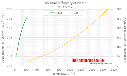

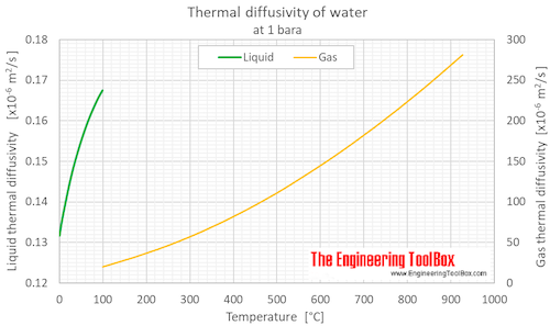

Water thermal diffusivity at atmospheric pressure, temperature given as °C or °F:

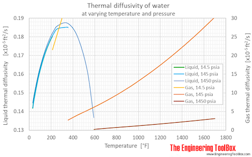

Water thermal diffusivity at 1, 10 and 100 bara (14.5, 145 and 1450 psia) pressure, temperature given as °C or °F:
