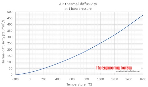

Air thermal diffusivity at 1 bara pressure, temperature given as °C or °F:
Air thermal diffusivity at varying temperatures and constant pressures, SI and Imperial units:

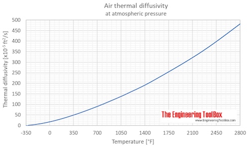

Air thermal diffusivity at atmospheric pressure, given in SI and Imperial units:
| Temperature | Thermal diffusivity | Temperature | Thermal diffusivity | |||||
| (K) | (°C) | (×10-6 m2/s) | (m2/h) | (K) | (°F) | (×10-5 ft2/s) | ( ft2/h) | |
| 173.2 | -100 | 7.88 | 0.02837 | 172.0 | -150 | 8.371 | 0.3014 | |
| 223.2 | -50 | 13.02 | 0.04686 | 213.7 | -75 | 12.89 | 0.4640 | |
| 243.2 | -30 | 15.33 | 0.05518 | 227.6 | -50 | 14.55 | 0.5238 | |
| 253.2 | -20 | 16.54 | 0.05953 | 241.5 | -25 | 16.29 | 0.5863 | |
| 263.2 | -10 | 17.78 | 0.06401 | 249.8 | -10 | 17.36 | 0.6251 | |
| 268.2 | -5 | 18.41 | 0.06629 | 255.4 | 0 | 18.09 | 0.6514 | |
| 273.2 | 0 | 19.06 | 0.06860 | 260.9 | 10 | 18.84 | 0.6782 | |
| 278.2 | 5 | 19.71 | 0.07094 | 266.5 | 20 | 19.59 | 0.7053 | |
| 283.2 | 10 | 20.36 | 0.07331 | 283.2 | 50 | 21.92 | 0.7891 | |
| 293.2 | 20 | 21.70 | 0.07813 | 297.0 | 75 | 23.93 | 0.8615 | |
| 298.2 | 25 | 22.39 | 0.08059 | 310.9 | 100 | 26.01 | 0.9363 | |
| 303.2 | 30 | 23.07 | 0.08307 | 324.8 | 125 | 28.15 | 1.013 | |
| 323.2 | 50 | 25.91 | 0.09327 | 338.7 | 150 | 30.34 | 1.092 | |
| 348.2 | 75 | 29.61 | 0.1066 | 366.5 | 200 | 34.92 | 1.257 | |
| 373.2 | 100 | 33.49 | 0.1206 | 394.3 | 250 | 39.71 | 1.430 | |
| 398.2 | 125 | 37.53 | 0.1351 | 422.0 | 300 | 44.71 | 1.610 | |
| 423.2 | 150 | 41.73 | 0.1502 | 449.8 | 350 | 49.91 | 1.797 | |
| 448.2 | 175 | 46.07 | 0.1659 | 477.6 | 400 | 55.30 | 1.991 | |
| 473.2 | 200 | 50.56 | 0.1820 | 505.4 | 450 | 60.86 | 2.191 | |
| 523.2 | 250 | 59.93 | 0.2157 | 533.2 | 500 | 66.59 | 2.397 | |
| 573.2 | 300 | 69.79 | 0.2512 | 588.7 | 600 | 78.52 | 2.827 | |

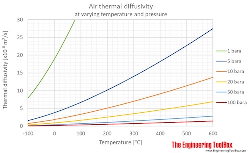

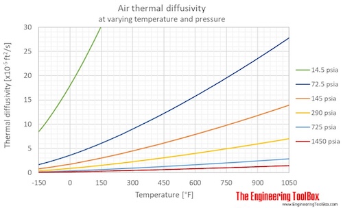

Air thermal diffusivity at given temperatures and 1, 5, 10 and 20 bara presure:
| Temperature | Thermal diffusivity at given pressures (×10-6 m2/s ) | |||||
| (K) | (°C) | (°F) | 1 bara, 14.5 psia | 5 bara, 72.5 psia | 10 bara, 145 psia | 20 bara, 145 psia |
| 60 | -213 | -352 | 0.0941 | 0.0942 | 0.0944 | 0.0947 |
| 80 | -193 | -316 | 1.59 | 0.0823 | 0.0826 | 0.0834 |
| 100 | -173 | -280 | 2.56 | 0.408 | 0.0643 | 0.0659 |
| 120 | -153 | -244 | 3.79 | 0.684 | 0.293 | 0.0814 |
| 140 | -133 | -208 | 5.21 | 0.983 | 0.455 | 0.189 |
| 180 | -93.2 | -136 | 8.58 | 1.68 | 0.815 | 0.385 |
| 200 | -73.2 | -99.7 | 10.5 | 2.07 | 1.02 | 0.490 |
| 220 | -53.2 | -63.7 | 12.6 | 2.50 | 1.23 | 0.602 |
| 240 | -33.2 | -27.7 | 14.9 | 2.96 | 1.46 | 0.721 |
| 260 | -13.2 | 8.3 | 17.3 | 3.44 | 1.67 | 0.847 |
| 273.2 | 0.0 | 32.0 | 19.0 | 3.78 | 1.86 | 0.940 |
| 280 | 6.9 | 44.3 | 19.9 | 3.96 | 1.97 | 0.979 |
| 288.7 | 15.6 | 60.0 | 21.0 | 4.20 | 2.10 | 1.05 |
| 300 | 26.9 | 80.3 | 22.6 | 4.50 | 2.25 | 1.12 |
| 320 | 46.9 | 116 | 25.4 | 5.07 | 2.53 | 1.26 |
| 340 | 66.9 | 152 | 28.3 | 5.67 | 2.83 | 1.41 |
| 360 | 86.9 | 188 | 31.4 | 6.28 | 3.14 | 1.57 |
| 380 | 107 | 224 | 34.6 | 6.92 | 3.46 | 1.73 |
| 400 | 127 | 260 | 37.9 | 7.58 | 3.79 | 1.90 |
| 500 | 227 | 440 | 55.7 | 11.2 | 5.59 | 2.80 |
| 600 | 327 | 620 | 75.4 | 15.1 | 7.57 | 3.80 |
| 700 | 427 | 800 | 96.8 | 19.4 | 9.71 | 4.88 |
| 800 | 527 | 980 | 119.7 | 24.0 | 12.0 | 6.03 |
| 900 | 627 | 1160 | 144.2 | 28.9 | 14.5 | 7.26 |
| 1000 | 727 | 1340 | 169.6 | 34.1 | 17.1 | 8.57 |
| 1100 | 827 | 1520 | 198.1 | 19.9 | ||
| 1500 | 1227 | 2240 | 326.7 | 32.7 | ||
| 1900 | 1627 | 2960 | 483.7 | 48.5 | ||
