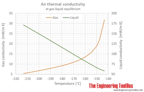

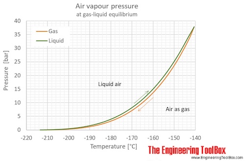

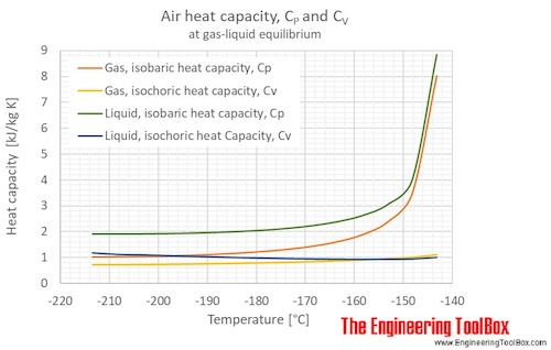

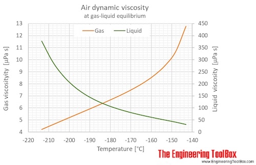

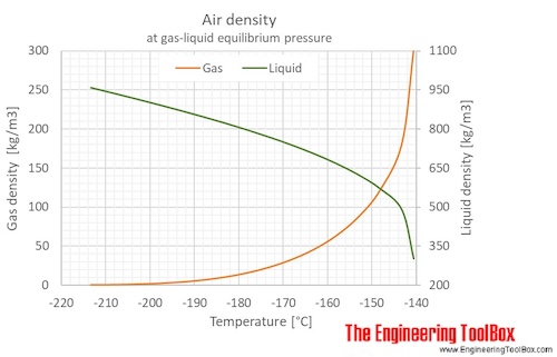

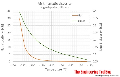

The figures below show the changes in thermophysical properties along the air boiling and condensation curves: Vapour pressure, density, viscosity, heat capacity, thermal conductivity.

The following figures show how the properties of air changes along the boiling and condensation curves (shown in the figure above) - SI units:
