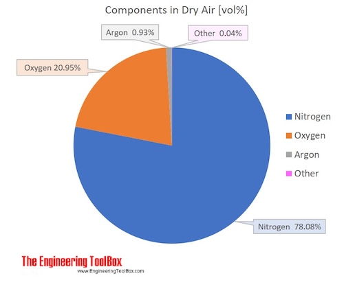

Air is a mixture of several gases, where the two most dominant components in dry air are 21 vol% oxygen and 78 vol% nitrogen . Oxygen has a molar mass of 15.9994 g/mol and nitrogen has a molar mass of 14.0067 g/mol. Since both of these elements are diatomic in air - O2 and N2, the molar mass of oxygen gas is aprox. 32 g/mol and the molar mass of nitrogen gas is aprox. 28 g/mol.

The molar mass of dry air with oxygen, nitrogen and the other components as indicated below is 28.9647 g/mol. Composition and content of each gas in air is given in the figures and the table below.

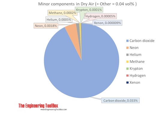

Components dry air
Minor components dry air

Name Formula (mol/molair) (vol %) (g/mol)
(kg/kmol)
(g/molair)
(kg/kmolair)
(wt %)
Nitrogen N2 0.78084 78.084 28.013 21.873983 75.52
Oxygen O2 0.20946 20.946 31.999 6.702469 23.14
Argon Ar 0.00934 0.934 39.948 0.373114 1.29
Carbon dioxide CO2 0.00033 0.033 44.010 0.014677 0.051
Neon Ne 0.00001818 0.001818 20.180 0.000367 0.0013
Helium He 0.00000524 0.000524 4.003 0.000021 0.00007
Methane CH4 0.00000179 0.000179 16.042 0.000029 0.00010
Krypton Kr 0.0000010 0.0001 83.798 0.000084 0.00029
Hydrogen H2 0.0000005 0.00005 2.016 0.000001 0.000003
Xenon Xe 0.00000009 0.000009 131.293 0.000012 0.00004
Average molar mass of air 28.9647
