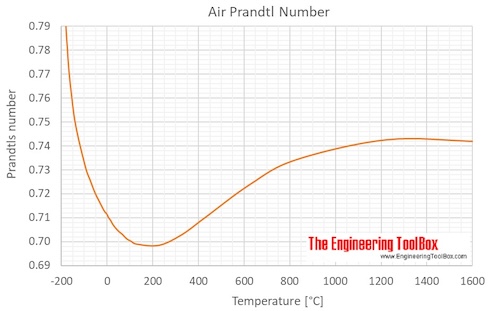

Air Prandtl number at 1 bara pressure, temperature given as °C or °F:

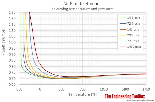

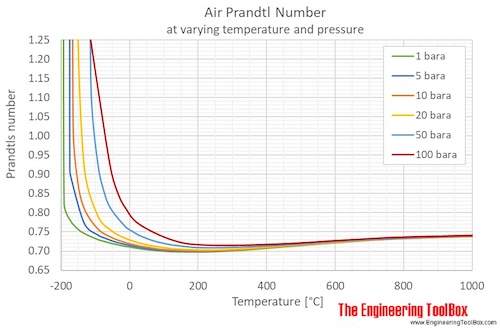

Air Prandtl number at varying temperatures and constant pressures, SI and Imperial units:
| Temperature | Pr | Temperature | Pr |
| (°C) | (-) | (°F) | (-) |
| -100 | 0.734 | -150 | 0.733 |
| -50 | 0.720 | -50 | 0.719 |
| 0 | 0.711 | 0 | 0.714 |
| 25 | 0.707 | 60 | 0.709 |
| 50 | 0.705 | 75 | 0.708 |
| 100 | 0.701 | 100 | 0.706 |
| 150 | 0.699 | 200 | 0.701 |
| 200 | 0.698 | 300 | 0.699 |
| 250 | 0.699 | 400 | 0.698 |
| 300 | 0.702 | 500 | 0.700 |
Air Prandtl number at given temperatures and 1, 5 10 and 20 bara pressure:
| Temperature | Prandtl number at given pressures | |||||
| (K) | (°C) | (°F) | 1 bara, 14.5 psia | 5 bara, 72.5 psia | 10 bara, 145 psia | 20 bara, 725 psia |
| 60 | -213.2 | -351.7 | 4.138 | 4.153 | 4.170 | 4.187 |
| 80 | -193.2 | -315.7 | 1.7 | 2.252 | 2.259 | 2.269 |
| 100 | -173.2 | -279.7 | 0.780 | 0.898 | 1.783 | 1.770 |
| 120 | -153.2 | -243.7 | 0.759 | 0.806 | 0.890 | 1.360 |
| 140 | -133.2 | -207.7 | 0.747 | 0.773 | 0.812 | 0.923 |
| 180 | -93.2 | -135.7 | 0.731 | 0.743 | 0.759 | 0.792 |
| 200 | -73.2 | -99.7 | 0.726 | 0.735 | 0.745 | 0.769 |
| 220 | -53.2 | -63.7 | 0.721 | 0.728 | 0.736 | 0.754 |
| 240 | -33.2 | -27.7 | 0.717 | 0.722 | 0.729 | 0.742 |
| 260 | -13.2 | 8.3 | 0.713 | 0.718 | 0.723 | 0.734 |
| 273 | 0.0 | 32.0 | 0.711 | 0.715 | 0.720 | 0.729 |
| 280 | 6.9 | 44.3 | 0.710 | 0.714 | 0.718 | 0.727 |
| 289 | 15.6 | 60.0 | 0.709 | 0.713 | 0.716 | 0.723 |
| 300 | 26.9 | 80.3 | 0.707 | 0.711 | 0.714 | 0.722 |
| 320 | 46.9 | 116.3 | 0.705 | 0.708 | 0.711 | 0.717 |
| 340 | 66.9 | 152.3 | 0.703 | 0.705 | 0.708 | 0.714 |
| 360 | 86.9 | 188.3 | 0.701 | 0.703 | 0.706 | 0.711 |
| 380 | 106.9 | 224.3 | 0.700 | 0.702 | 0.704 | 0.709 |
| 400 | 126.9 | 260.3 | 0.699 | 0.701 | 0.703 | 0.706 |
| 500 | 226.9 | 440.3 | 0.698 | 0.700 | 0.701 | 0.703 |
| 600 | 326.9 | 620.3 | 0.703 | 0.704 | 0.704 | 0.706 |
| 700 | 426.9 | 800.3 | 0.710 | 0.710 | 0.711 | 0.712 |
| 800 | 526.9 | 980.3 | 0.717 | 0.718 | 0.718 | 0.719 |
| 900 | 626.9 | 1160.3 | 0.724 | 0.725 | 0.725 | 0.725 |
| 1000 | 726.9 | 1340.3 | 0.730 | 0.730 | 0.730 | 0.731 |
| 1100 | 826.9 | 1520.3 | 0.734 | 0.735 | ||
| 1500 | 1226.9 | 2240.3 | 0.743 | 0.743 | ||
| 1900 | 1626.9 | 2960.3 | 0.742 | 0.742 | ||
