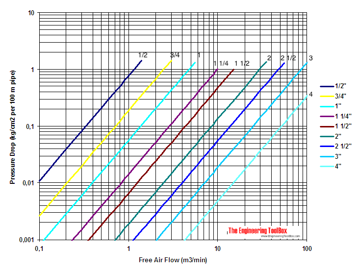

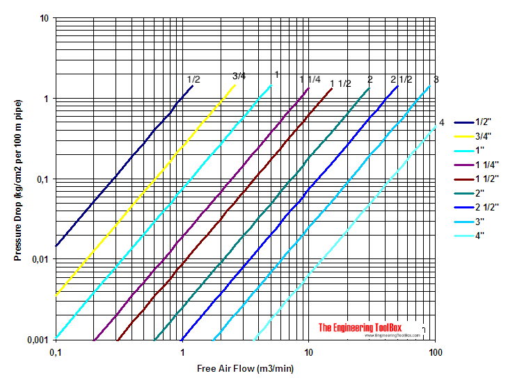

Compressed air pipeline pressure drop in kg/m2 per 100 m pipe can be estimated for typical entering pressures in the diagrams below. The diagrams are calculated for schedule 40 pipes.
Other dimensions or pressures can be calculated with the
Compressed Air Entering Pressure 5 kg/cm2
compressed air pressure diagram metric units 5 kg/m3
  • 1 kg/cm2 = 0.98 bar = 735 mmHg = 10000 mmH2O = 14.2 psi
  • 1 m3/min = 0.017 m3/s = 60 m3/h = 1000 liter/min = 35.3 cfm

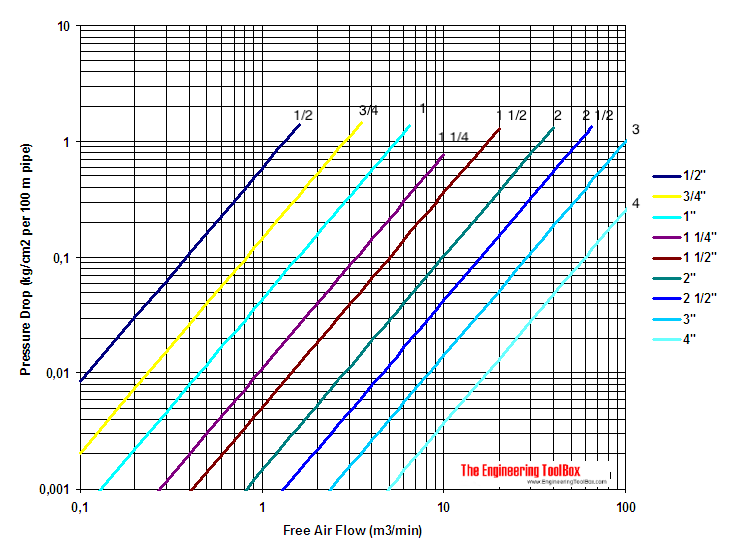

Compressed Air Entering Pressure 7.5 kg/cm2
compressed air pressure diagram metric units 7.5 kg/m3

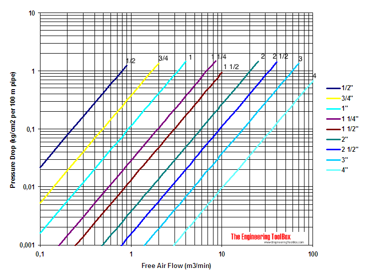

Compressed Air Entering Pressure 10 kg/cm2
compressed air pressure diagram metric units 10 kg/m3
