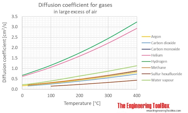

Figure and table below shows the diffusion coefficients, D12 , for binary gas mixtures where air is in large excess.
See also Air Composition and molecular weight, Density at varying pressure, Density and specific weight at varying temperature, Diffusion coefficients for gases in air, Dynamic (absolute) and kinematic viscosity, Prandtl Number, Specific heat at varying temperature and Specific heat at varying pressure, Thermal conductivity, Thermal diffusivity, Properties at gas-liquid equilibrium conditions and Air properties, for other properties of air, as well as Diffusion coefficients of gases in water and Carbon dioxide concentrations in rooms with people
Diff coeff gas air temperature C
