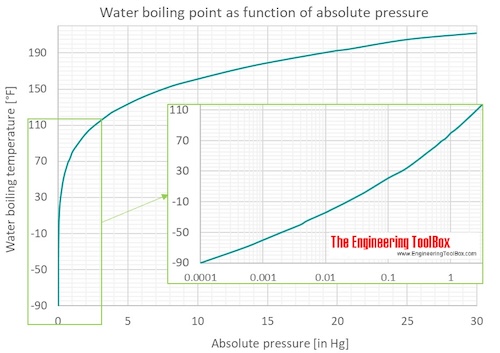

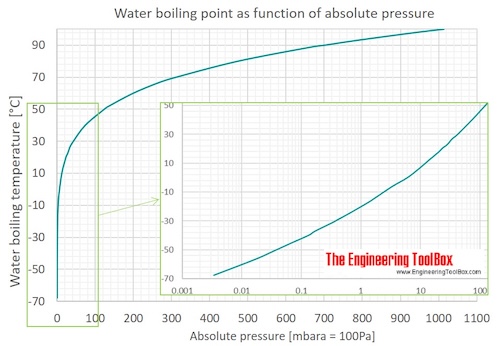

Below, figures and tables show the boiling point of water at varying vacuum .

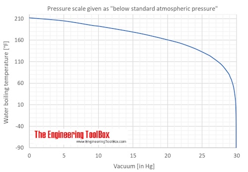

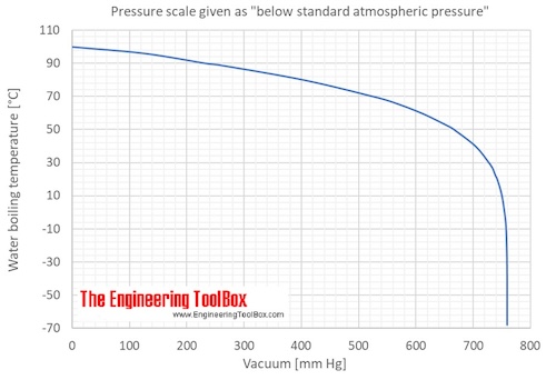

Boiling point as function of the pressure, given as "mm Hg below standard atmospheric pressure":
(= Vacuum of e.g. 100 mm Hg is the same as (760-100)=660 mm Hg absolute pressure)
