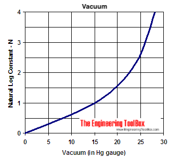

(1) can be simplified to
t = V / q N                                       (2)
N = natural log constant for the actual vacuum
N = 1 for vacuum up to 15 in Hg gauge
N = 2 for vacuum up to 22.5 in Hg gauge
N = 3 for vacuum up to 26 in Hg gauge
N = 4 for vacuum up to 28 in Hg gauge
vacuum evacuation time diagram

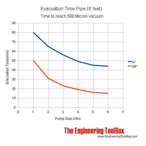

Estimated Evacuation Time to Reach 500 Micron Vacuum - 6 feet pipe
vacuum evacuation time pipe
