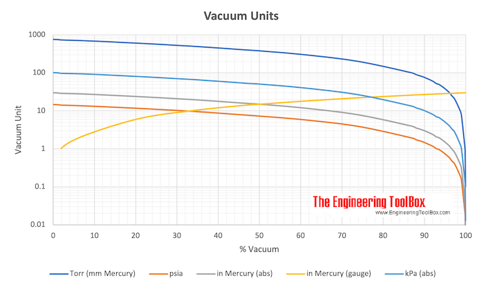

Vacuum Units Converter Chart
Download and print Vacuum Units Converter Chart
