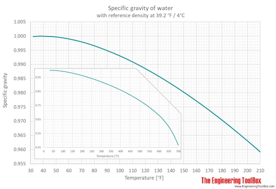

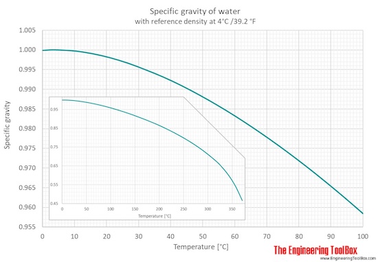

It is most common to use the density of water at 4 oC (39 oF) as a reference since water at this point has its highest density of 1000 kg/m 3 or 1.940 sl/ft3 . However, also the density at 60 °F (15.6°C) or 20 °C is often used as the reference temperature, e.g. related to crude oils and petroleum products. Water is normally also used as reference when calculating the specific gravity for solids. For gases it is air at room temperature (25°C). Pressure is nearly always 1 atm (101.325 kPa). The temperature and pressure must always be specified for both the sample and the reference.
Specific Gravity - SG - is dimensionless and has the same value in the SI system and the Imperial English system (BG).
Specific gravity of liquid water ranging 32 - 700 oF and 0 - 370 oC is given in figures and tables below:

Specific gravity (SG) for water is given for four different reference temperatures (4, 15, 15.6 and 20°C).
From 0 to 100°C the pressure is 1 atm, and for temperatures >100°C, the pressure is equal to water saturation pressure .

Specific gravity (SG) for water is given for four different reference temperatures (39.2, 59, 60 and 68°F).
From 32 to 212°F the pressure is 14.7 psi, and for temperatures >212°F, the pressure is equal to water saturation pressure .
