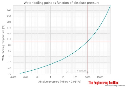

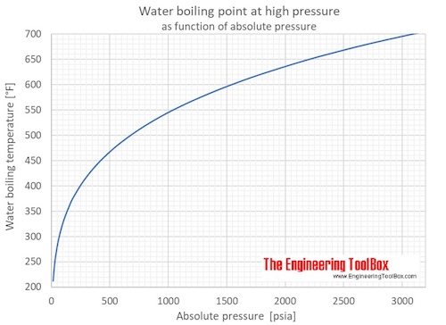

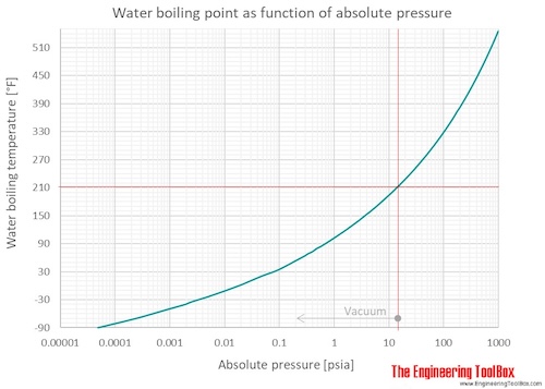

Boiling points of water at absolute pressures ranging from 1 to 70 bara or 14.7 to 1000 psia are indicated in the figures and tables below:
