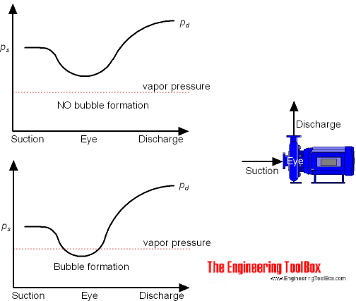

Low pressure at the suction side of a pump may cause the fluid to start boiling with
  • reduced efficiency
  • cavitation
  • damage
of the pump as a result. Boiling starts when the pressure in the liquid is reduced to the vapor pressure of the fluid at the actual temperature.
Pumps - cavitation and bubble formation
To characterize the potential for boiling and cavitation the difference between
  • the total head on the suction side of the pump - close to the impeller, and
  • the liquid vapor pressure at the actual temperature
can be used.

Net Positive Suction Head - NPSH
The Net Positive Suction Head - NPSH - can be defined as
  • the difference between the Suction Head, and
  • the Liquids Vapor Head
and can be expressed as
NPSH = hs - hv                             (3)
or, by combining (1) and (2)
NPSH = ps / γ + vs2 / 2 g - pv / γ                               (3b)

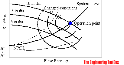

Required NPSH - NPSHr or NPSHR
The NPSHr, called as the Net Suction Head as required by the pump in order to prevent cavitation for safe and reliable operation of the pump.
The required NPSHr for a particular pump is in general determined experimentally by the pump manufacturer and a part of the documentation of the pump.
Pump efficiency - BEP - Best Efficiency Point
The available NPSHa of the system should always exceeded the required NPSHr of the pump to avoid vaporization and cavitation of the impellers eye. The available NPSHa should in general be significant higher than the required NPSHr to avoid that head loss in the suction pipe and in the pump casing, local velocity accelerations and pressure decreases, start boiling the fluid on the impellers surface.
Note that required NPSHr increases with the square of capacity.
Pumps with double-suction impellers has lower NPSHr than pumps with single-suction impellers. A pump with a double-suction impeller is considered hydraulically balanced but is susceptible to an uneven flow on both sides with improper pipe-work.
