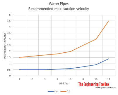

More about NPSH and suction problems:
Water Pipes - Maximum Suction Velocity
