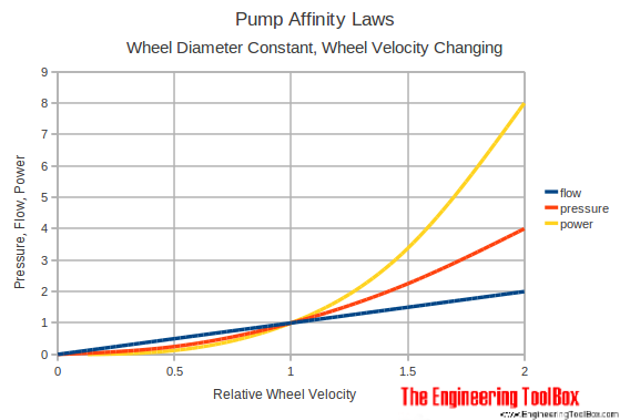

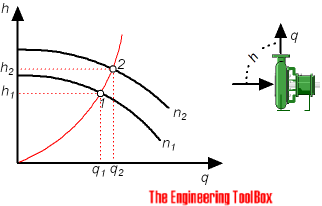

Changing Wheel Velocity
centrifugal pumps affinity laws
If the wheel diameter is constant - change in pump wheel velocity can simplify the affinity laws to
Volume Capacity
q1 / q2 = (n1 / n2)                                               (1a)
Head or Pressure
dp1 / dp2 = (n1 / n2)2                                            (2a)
Power
P1 / P2 = (n1 / n2)3                                            (3a)
pump affinity laws - changing wheel velocity diagram
Note! If the speed of a pump is increased with 10%
  • the volume flow increases with 10%
  • the head increases with 21%
  • the power increases with 33 %
If we want to increase the volume flow capacity of an existing system with 10% we have to increase the power supply with 33% .

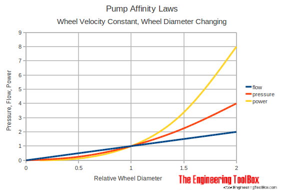

Changing the Impeller Diameter
If wheel velocity is constant a change in impeller diameter simplifies the affinity laws to
Volume Capacity
q1 / q2 = d1 / d2                               (1b)
Head or Pressure
dp1 / dp2 = (d1 / d2)2                            (2b)
Power
P1 / P2 = (d1 / d2)3                              (3b)

Example - Pump Affinity Laws - Changing Pump Speed
The pump speed is changed when the impeller size is constant. The initial flow is 100 gpm , the initial head is 100 ft , the initial power is 5 bhp , the initial speed is 1750 rpm and the final speed 3500 rpm .
The final flow capacity can be calculated with (1a):
q2 = q1 n2 / n1
= (100 gpm) (3500 rpm) / (1750 rpm)
= 200 gpm
The final head can be calculated with (2a):
dp2 = dp1 (n2 / n1)2
= (100 ft) ((3500 rpm) / (1750 rpm))2
= 400 ft
The final power consumption can be calculated with (3a):
P2 = P1 (n2 / n1)3
= (5 bhp) ((3500 rpm) / (1750 rpm))3
= 40 bhp
Example - Pump Affinity Laws - Changing Impeller Diameter
The diameter of the pump impeller is reduced when the pump speed is constant. The diameter is changed from 8 to 6 inches .
The final flow capacity can be calculated with (1b) :
q2 = q1 (d2 / d1)
= (100 gpm) ((¨6 in) / (8 in))
= 75 gpm
The final head can be calculated with (2b) :
dp2 = dp1 (d2 / d1)2
= (100 ft) ((6 in) / (8 in))2
= 56.3 ft
The final power consumption can be calculated with (3b) :
P2 = P1 (d2 / d1)3
= (5 bhp) ((6 in) / (8 in))3
= 2.1 bhp
