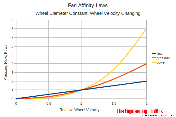

Changing the Wheel Velocity
If the wheel diameter is constant - the affinity laws for change in wheel velocity can be simplified to
Volume Flow Capacity
q1 / q2 = (n1 / n2)                                        (1a)
Head or Pressure
dp1 / dp2 = (n1 / n2)2                                    (2a)
Power
P1 / P2 = (n1 / n2)3                                      (3a)
fan affinity laws velocity diagram
Note! - if the speed of a fan is increased with 10%
  • the volume flow is increased with 10%
  • the head is increased with 21%
  • the power is increased with 33 %
- if the volume flow capacity of an existing system is increased with 10% - the power supply increases with 33% and the electrical motor and the power supply may need an upgrade.

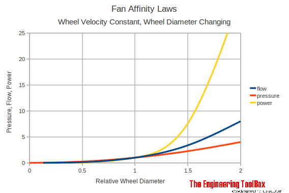

Changing the Impeller Diameter
If the wheel velocity is constant - the affinity laws for change in impeller diameter can be simplified to
Volume Capacity
q1 / q2 = (d1 / d2)3                      (1b)
Head or Pressure
dp1 / dp2 = (d1 / d2)2                      (2b)
Power
P1 / P2 = (d1 / d2)5                         (3b)
