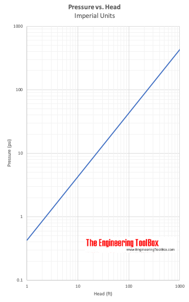

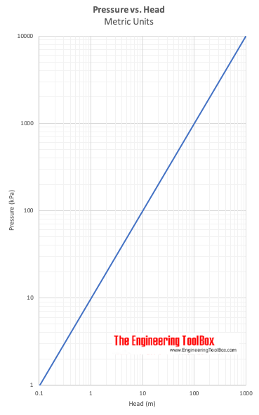

Pressure vs. Head
(6) can be transformed to:
Δh = (p2 - p1) / γ                                (7)
Δh express head - the height difference  of a column of fluid of specific weight - γ - required to give a pressure difference Δp = p2 - p1 .
Example - Pressure vs. Head
A pressure difference of 5 psi (lbf/in2) is equivalent to head in water
(5 lbf/in2) (12 in/ft) (12 in/ft) / (62.4 lb/ft3)
= 11.6 ft of water
or head in Mercury
(5 lbf/in2) (12 in/ft) (12 in/ft) / (847 lb/ft3)
= 0.85 ft of mercury
Specific weight of water is 62.4 (lb/ft3) and specific weight of mercury is 847 (lb/ft3) .
Pressure vs. Head - Metric Units
Pressure vs. Head - Imperial Units
