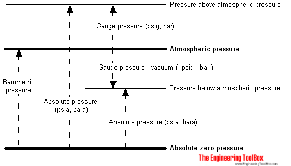

Pressure - absolute versus gauge
Absolute Pressure
The absolute pressure - pabs - is measured relative to the absolute zero pressure - the pressure that would occur at absolute vacuum. All calculations involving the gas law requires pressure (and temperature) to be in absolute units.
Gauge Pressure
A gauge is often used to measure the pressure difference between a system and the surrounding atmosphere. This pressure is often called the gauge pressure and can be expressed as
pg = ps - patm                          (2)
pg = gauge pressure (Pa, psi)
ps = system pressure (Pa, psi)
patm = atmospheric pressure (Pa, psi)

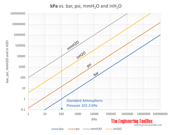

kPa vs bar, psi, mmh2o and inh2o
Download kPa to bar, psi, mmH2O and inH2O chart
