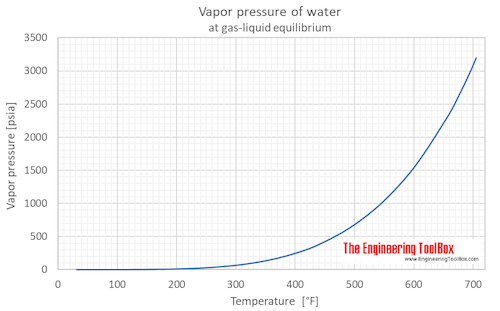

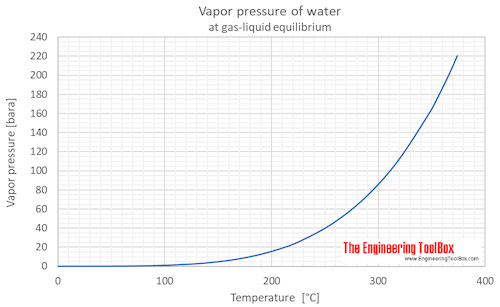

Vapor pressure of water as function of temperature (°C and °F):
See Water - Saturation pressure for calculator of equilibrium pressure at varying temperature.

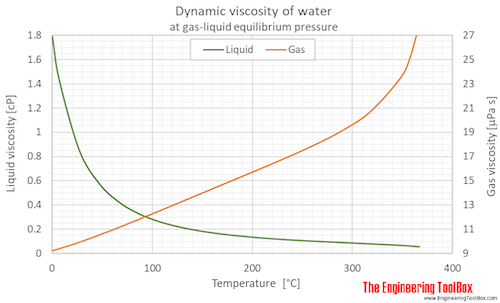

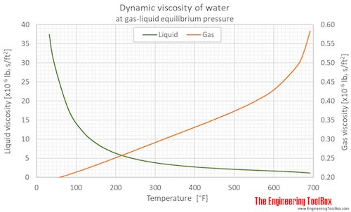

Dynamic viscosity of water (liquid and vapor) as function of temperature (°C and °F):
See Water - Dynamic and Kinematic Viscosity for calculator and variations at constant pressures.

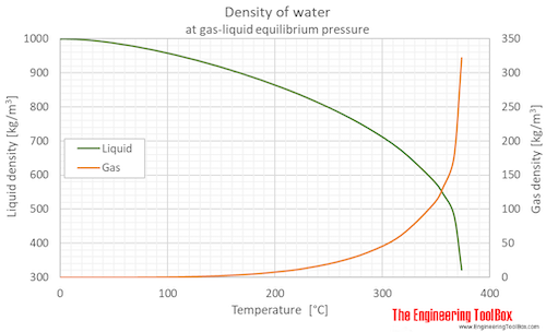

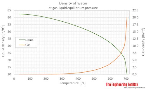

Density of water (liquid and vapor) as function of temperature (°C and °F):
See Water - Density, Specific Weight and Thermal Expantion Coefficient for calculator and variations at constant pressures.

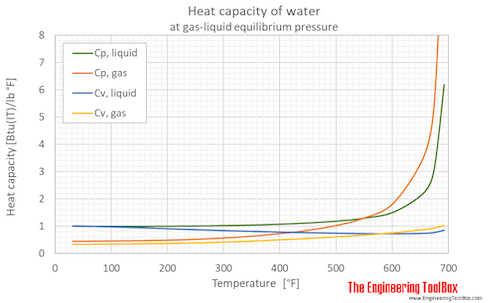

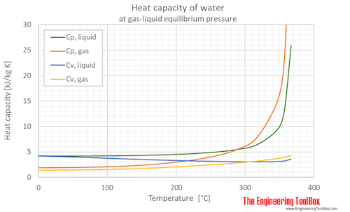

Specific heat (heat capacity) of water (liquid and vapor) as function of temperature (°C and °F):
See Water - Specific heat (heat capacity) for calculator of heat capacity at given temperatures .

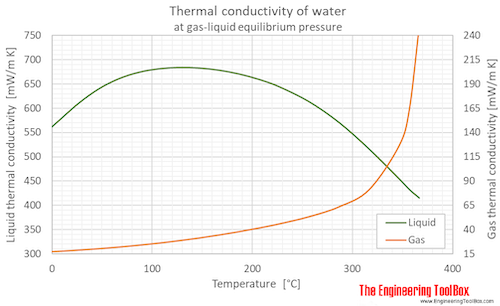

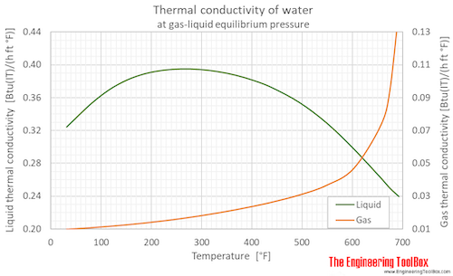

Thermal conductivity of water (liquid and vapor) as function of temperature (°C and °F):
See Water - Thermal Conductivity for variations at constant pressures.

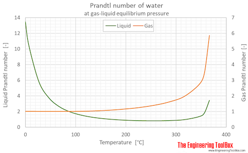

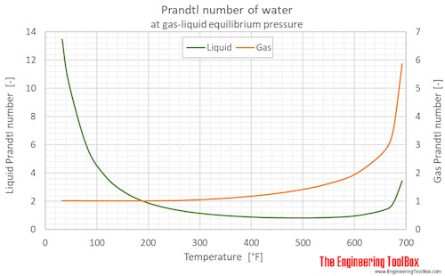

Prandtl number of water (liquid and vapor) as function of temperature (°C and °F):
See Water - Prandtl Number for variations at constant pressures.

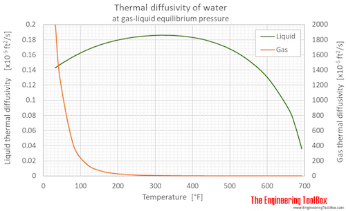

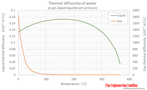

Thermal diffusivity of water (liquid and vapor) as function of temperature (°C and °F):
See Water - Thermal Diffusivity for variations at constant pressures.

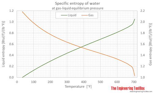

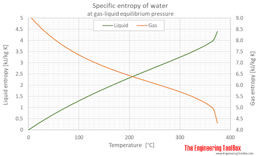

Specific entropy of water (liquid and vapor) as function of temperature (°C and °F):
See Water - Enthalpy and Entropy for tabulated values in different units.

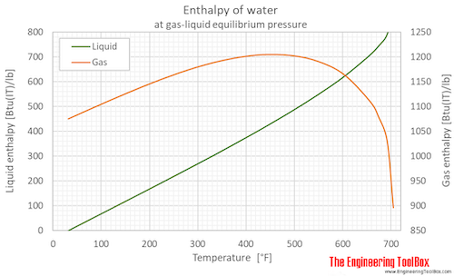

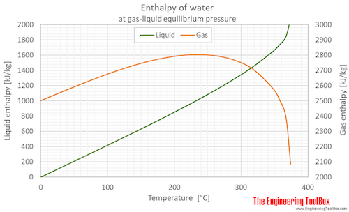

Enthalpy of water (liquid and vapor) as function of temperature (°C and °F):
Tabulated values for water properties at gas-liquid equilibrium pressure, given in SI units:
For full table with Thermal Conductivity, Dynamic Viscosity, Enthalpy, Specific Entropy, Prandtl Number and Thermal Diffusivity - rotate the screen!
| State | Temperature | Pressure | Density | Heat Capacity CV | Heat Capacity CP | CP/CV | Thermal Conductivity | Dynamic Viscosity | Enthalpy | Specific Entropy | Prandtl Number | Thermal Diffusivity | |
| (K) | (°C) | (bara) | (g/l), (kg/m3) | (kJ/kg K) | (kJ/kg K) | (-) | (mW/m K) | (μPa s) | (kJ/kg) | (kJ/kgK) | (-) | (×10-6 m2/s) | |
| Liquid | 273.16 | 0.01 | 6.1E-03 | 999.8 | 4.217 | 4.231 | 1.003 | 561.4 | 1791 | 6.11E-04 | 0 | 13.50 | 0.1327 |
| 280 | 6.9 | 0.0099 | 999.9 | 4.200 | 4.201 | 1.000 | 574.0 | 1434 | 28.80 | 0.1041 | 10.49 | 0.1367 | |
| 300 | 26.9 | 0.0354 | 996.5 | 4.130 | 4.181 | 1.012 | 610.3 | 853.8 | 112.6 | 0.3931 | 5.849 | 0.1465 | |
| 320 | 46.9 | 0.105 | 989.4 | 4.042 | 4.181 | 1.034 | 639.7 | 577.0 | 196.2 | 0.6628 | 3.771 | 0.1547 | |
| 340 | 66.9 | 0.272 | 979.5 | 3.942 | 4.188 | 1.063 | 660.6 | 422.0 | 279.9 | 0.9165 | 2.676 | 0.1610 | |
| 360 | 86.9 | 0.622 | 967.4 | 3.837 | 4.202 | 1.095 | 673.8 | 326.1 | 363.8 | 1.156 | 2.034 | 0.1657 | |
| 380 | 107 | 1.29 | 953.3 | 3.733 | 4.224 | 1.132 | 681.0 | 262.7 | 448.1 | 1.384 | 1.629 | 0.1691 | |
| 400 | 127 | 2.46 | 937.5 | 3.632 | 4.255 | 1.172 | 683.6 | 218.6 | 533.0 | 1.601 | 1.361 | 0.1714 | |
| 420 | 147 | 4.37 | 919.9 | 3.538 | 4.299 | 1.215 | 682.5 | 186.7 | 618.6 | 1.810 | 1.176 | 0.1726 | |
| 440 | 167 | 7.34 | 900.7 | 3.449 | 4.357 | 1.263 | 678.1 | 162.8 | 704.5 | 2.011 | 1.046 | 0.1728 | |
| 460 | 187 | 11.7 | 879.6 | 3.368 | 4.433 | 1.316 | 670.3 | 144.3 | 793.4 | 2.205 | 0.955 | 0.1719 | |
| 480 | 207 | 17.9 | 856.5 | 3.293 | 4.533 | 1.376 | 659.1 | 129.6 | 883.3 | 2.395 | 0.892 | 0.1697 | |
| 500 | 227 | 26.4 | 831.3 | 3.226 | 4.663 | 1.446 | 644.1 | 117.7 | 975.4 | 2.581 | 0.852 | 0.1661 | |
| 530 | 257 | 44.6 | 788.5 | 3.138 | 4.947 | 1.576 | 613.2 | 103.1 | 1119 | 2.856 | 0.831 | 0.1572 | |
| 560 | 287 | 71.1 | 737.8 | 3.072 | 5.424 | 1.765 | 570.2 | 90.86 | 1273 | 3.132 | 0.864 | 0.1425 | |
| 590 | 317 | 108 | 674.8 | 3.042 | 6.378 | 2.097 | 515.4 | 79.60 | 1443 | 3.418 | 0.985 | 0.1198 | |
| 620 | 347 | 159 | 586.9 | 3.114 | 9.354 | 3.004 | 454.1 | 67.38 | 1646 | 3.740 | 1.388 | 0.08272 | |
| 630 | 357 | 180 | 544.2 | 3.228 | 12.8269 | 3.974 | 432.5 | 62.24 | 1731 | 3.870 | 1.846 | 0.06196 | |
| 640 | 367 | 203 | 481.5 | 3.581 | 25.9424 | 7.244 | 414.9 | 55.25 | 1842 | 4.038 | 3.454 | 0.03322 | |
| 647.1 | 373.95 | 221 | 322.0 | 2084 | 4.407 | ||||||||
| Gas | 273.16 | 0.01 | 6.1E-03 | 0.00485 | 1.418 | 1.884 | 1.328 | 17.07 | 9.216 | 2501 | 9.156 | 1.017 | 1869 |
| 280 | 6.9 | 0.0099 | 0.00767 | 1.424 | 1.891 | 1.328 | 17.44 | 9.382 | 2513 | 8.978 | 1.017 | 1202 | |
| 300 | 26.9 | 0.0354 | 0.02558 | 1.442 | 1.914 | 1.327 | 18.67 | 9.920 | 2550 | 8.517 | 1.017 | 381.3 | |
| 320 | 46.9 | 0.105 | 0.07166 | 1.463 | 1.942 | 1.328 | 20.12 | 10.52 | 2586 | 8.130 | 1.015 | 144.6 | |
| 340 | 66.9 | 0.272 | 0.1744 | 1.489 | 1.979 | 1.329 | 21.78 | 11.16 | 2621 | 7.801 | 1.014 | 63.11 | |
| 360 | 86.9 | 0.622 | 0.3786 | 1.525 | 2.033 | 1.333 | 23.70 | 11.82 | 2654 | 7.519 | 1.014 | 30.79 | |
| 380 | 107 | 1.29 | 0.7483 | 1.575 | 2.110 | 1.339 | 25.88 | 12.50 | 2686 | 7.274 | 1.019 | 16.39 | |
| 400 | 127 | 2.46 | 1.369 | 1.643 | 2.218 | 1.350 | 28.35 | 13.19 | 2716 | 7.058 | 1.032 | 9.332 | |
| 420 | 147 | 4.37 | 2.352 | 1.734 | 2.367 | 1.365 | 31.13 | 13.88 | 2742 | 6.866 | 1.055 | 5.593 | |
| 440 | 167 | 7.34 | 3.833 | 1.845 | 2.560 | 1.388 | 34.23 | 14.57 | 2765 | 6.691 | 1.090 | 3.489 | |
| 460 | 187 | 11.7 | 5.983 | 1.974 | 2.801 | 1.419 | 37.66 | 15.26 | 2783 | 6.530 | 1.135 | 2.247 | |
| 480 | 207 | 17.9 | 9.014 | 2.117 | 3.098 | 1.463 | 41.46 | 15.95 | 2796 | 6.380 | 1.192 | 1.485 | |
| 500 | 227 | 26.4 | 13.20 | 2.271 | 3.463 | 1.525 | 45.67 | 16.65 | 2802 | 6.235 | 1.263 | 0.9991 | |
| 530 | 257 | 44.6 | 22.47 | 2.527 | 4.209 | 1.666 | 53.13 | 17.76 | 2798 | 6.024 | 1.407 | 0.5618 | |
| 560 | 287 | 71.1 | 37.15 | 2.822 | 5.410 | 1.917 | 63.34 | 19.01 | 2771 | 5.807 | 1.623 | 0.3152 | |
| 590 | 317 | 108 | 61.24 | 3.184 | 7.768 | 2.440 | 81.11 | 20.63 | 2710 | 5.565 | 1.976 | 0.1705 | |
| 620 | 347 | 159 | 106.3 | 3.674 | 14.94 | 4.067 | 126.7 | 23.37 | 2584 | 5.253 | 2.758 | 0.07973 | |
| 630 | 357 | 180 | 132.8 | 3.911 | 22.66 | 5.793 | 163.4 | 25.02 | 2511 | 5.108 | 3.468 | 0.05430 | |
| 640 | 367 | 203 | 177.1 | 4.306 | 52.59 | 12.21 | 250.0 | 27.94 | 2396 | 4.903 | 5.876 | 0.02684 | |
| 647.1 | 373.95 | 221 | 322.0 | 2084 | 4.306 | ||||||||
Tabulated values for water properties at gas-liquid equilibrium pressure, given in Imperial units:
For full table with Thermal Conductivity, Dynamic Viscosity, Enthalpy, Specific Entropy, Prandtl Number and Thermal Diffusivity -- rotate the screen!
| State | Temperature | Pressure | Density | Heat Capacity CV | Heat Capacity CP | CP/CV | Thermal Conductivity | Dynamic Viscosity | Enthalpy | Specific Entropy | Prandtl Number | Thermal Diffusivity | ||
| (K) | (°F) | (psia) | (lb/ft3) | (Btu(IT)/lb °F) | (Btu(IT)/lb °F) | (-) | (Btu(IT)/h ft °F) | (×10-6 lbf s/ft2) | (×10-6 lbm s/ft s) | (Btu(IT)/lb) | (Btu(IT)/(lb °F)) | (-) | (×10-5ft2/s) | |
| Liquid | 273.16 | 32.018 | 0.0888 | 62.42 | 1.007 | 1.011 | 1.003 | 0.3244 | 37.41 | 1204 | 2.63E-04 | 0 | 13.50 | 0.1428 |
| 280 | 44.3 | 0.144 | 62.42 | 1.003 | 1.003 | 1.000 | 0.3317 | 29.94 | 963.4 | 12.38 | 0.02487 | 10.49 | 0.1471 | |
| 300 | 80.3 | 0.513 | 62.21 | 0.9865 | 0.9986 | 1.012 | 0.3526 | 17.83 | 573.8 | 48.39 | 0.09389 | 5.849 | 0.1577 | |
| 320 | 116 | 1.53 | 61.77 | 0.9653 | 0.9985 | 1.034 | 0.3696 | 12.05 | 387.7 | 84.34 | 0.1583 | 3.771 | 0.1665 | |
| 340 | 152 | 3.94 | 61.15 | 0.9414 | 1.000 | 1.063 | 0.3817 | 8.813 | 283.6 | 120.3 | 0.2189 | 2.676 | 0.1733 | |
| 360 | 188 | 9.02 | 60.39 | 0.9164 | 1.004 | 1.095 | 0.3893 | 6.811 | 219.1 | 156.4 | 0.2762 | 2.034 | 0.1784 | |
| 380 | 224 | 18.7 | 59.51 | 0.8916 | 1.009 | 1.132 | 0.3935 | 5.486 | 176.5 | 192.6 | 0.3306 | 1.629 | 0.1820 | |
| 400 | 260 | 35.6 | 58.52 | 0.8676 | 1.016 | 1.172 | 0.3950 | 4.566 | 146.9 | 229.1 | 0.3825 | 1.361 | 0.1845 | |
| 420 | 296 | 63.4 | 57.43 | 0.8449 | 1.027 | 1.215 | 0.3944 | 3.899 | 125.4 | 265.9 | 0.4322 | 1.176 | 0.1858 | |
| 440 | 332 | 106 | 56.23 | 0.8238 | 1.041 | 1.263 | 0.3918 | 3.400 | 109.4 | 302.9 | 0.4802 | 1.046 | 0.1860 | |
| 460 | 368 | 170 | 54.91 | 0.8044 | 1.059 | 1.316 | 0.3873 | 3.014 | 96.97 | 341.1 | 0.5267 | 0.955 | 0.1850 | |
| 480 | 404 | 260 | 53.47 | 0.7866 | 1.083 | 1.376 | 0.3808 | 2.708 | 87.11 | 379.8 | 0.5721 | 0.892 | 0.1827 | |
| 500 | 440 | 383 | 51.90 | 0.7704 | 1.114 | 1.446 | 0.3721 | 2.457 | 79.06 | 419.4 | 0.6165 | 0.852 | 0.1788 | |
| 530 | 494 | 646 | 49.23 | 0.7495 | 1.182 | 1.576 | 0.3543 | 2.152 | 69.25 | 481.2 | 0.6822 | 0.831 | 0.1692 | |
| 560 | 548 | 1031 | 46.06 | 0.7338 | 1.295 | 1.765 | 0.3295 | 1.898 | 61.05 | 547.3 | 0.7481 | 0.864 | 0.1534 | |
| 590 | 602 | 1569 | 42.13 | 0.7266 | 1.523 | 2.097 | 0.2978 | 1.662 | 53.49 | 620.4 | 0.8164 | 0.985 | 0.1289 | |
| 620 | 656 | 2306 | 36.64 | 0.7438 | 2.234 | 3.004 | 0.2624 | 1.407 | 45.28 | 707.5 | 0.8932 | 1.388 | 0.08903 | |
| 630 | 674 | 2606 | 33.98 | 0.7710 | 3.064 | 3.974 | 0.2499 | 1.300 | 41.83 | 744.1 | 0.9243 | 1.846 | 0.06669 | |
| 640 | 692 | 2939 | 30.06 | 0.8554 | 6.196 | 7.244 | 0.2397 | 1.154 | 37.12 | 791.8 | 0.9644 | 3.454 | 0.03575 | |
| 647.1 | 705.11 | 3200 | 20.10 | 896.1 | 1.053 | |||||||||
| Gas | 273.16 | 32.018 | 0.0888 | 3.03E-04 | 0.3388 | 0.4501 | 1.328 | 0.00986 | 0.1925 | 6.193 | 1075 | 2.187 | 1.017 | 2012 |
| 280 | 44.3 | 0.144 | 4.79E-04 | 0.3402 | 0.4517 | 1.328 | 0.01008 | 0.1959 | 6.304 | 1081 | 2.144 | 1.017 | 1293 | |
| 300 | 80.3 | 0.513 | 0.00160 | 0.3445 | 0.4572 | 1.327 | 0.01079 | 0.2072 | 6.666 | 1096 | 2.034 | 1.017 | 410.5 | |
| 320 | 116 | 1.53 | 0.00447 | 0.3493 | 0.4638 | 1.328 | 0.01162 | 0.2197 | 7.068 | 1112 | 1.942 | 1.015 | 155.6 | |
| 340 | 152 | 3.94 | 0.01089 | 0.3556 | 0.4727 | 1.329 | 0.01259 | 0.2330 | 7.497 | 1127 | 1.863 | 1.014 | 67.93 | |
| 360 | 188 | 9.02 | 0.02363 | 0.3642 | 0.4855 | 1.333 | 0.01369 | 0.2469 | 7.945 | 1141 | 1.796 | 1.014 | 33.15 | |
| 380 | 224 | 18.7 | 0.04671 | 0.3762 | 0.5039 | 1.339 | 0.01495 | 0.2612 | 8.402 | 1155 | 1.737 | 1.019 | 17.64 | |
| 400 | 260 | 35.6 | 0.08549 | 0.3925 | 0.5298 | 1.350 | 0.01638 | 0.2755 | 8.865 | 1168 | 1.686 | 1.032 | 10.04 | |
| 420 | 296 | 63.4 | 0.1468 | 0.4140 | 0.5652 | 1.365 | 0.01799 | 0.2900 | 9.329 | 1179 | 1.640 | 1.055 | 6.020 | |
| 440 | 332 | 106 | 0.2393 | 0.4406 | 0.6114 | 1.388 | 0.01978 | 0.3044 | 9.793 | 1189 | 1.598 | 1.090 | 3.755 | |
| 460 | 368 | 170 | 0.3735 | 0.4715 | 0.6691 | 1.419 | 0.02176 | 0.3187 | 10.25 | 1196 | 1.560 | 1.135 | 2.419 | |
| 480 | 404 | 260 | 0.5627 | 0.5056 | 0.7399 | 1.463 | 0.02395 | 0.3332 | 10.72 | 1202 | 1.524 | 1.192 | 1.598 | |
| 500 | 440 | 383 | 0.8240 | 0.5425 | 0.8271 | 1.525 | 0.02639 | 0.3478 | 11.19 | 1205 | 1.489 | 1.263 | 1.075 | |
| 530 | 494 | 646 | 1.403 | 0.6035 | 1.005 | 1.666 | 0.03070 | 0.3708 | 11.93 | 1203 | 1.439 | 1.407 | 0.6047 | |
| 560 | 548 | 1031 | 2.319 | 0.6741 | 1.292 | 1.917 | 0.03660 | 0.3970 | 12.77 | 1191 | 1.387 | 1.623 | 0.3393 | |
| 590 | 602 | 1569 | 3.823 | 0.7605 | 1.855 | 2.440 | 0.04686 | 0.4310 | 13.87 | 1165 | 1.329 | 1.976 | 0.1835 | |
| 620 | 656 | 2306 | 6.636 | 0.8776 | 3.569 | 4.067 | 0.07318 | 0.4882 | 15.71 | 1111 | 1.255 | 2.758 | 0.08582 | |
| 630 | 674 | 2606 | 8.293 | 0.9342 | 5.412 | 5.793 | 0.09443 | 0.5225 | 16.81 | 1080 | 1.220 | 3.468 | 0.05845 | |
| 640 | 692 | 2939 | 11.06 | 1.028 | 12.56 | 12.21 | 0.1445 | 0.5835 | 18.77 | 1030 | 1.171 | 5.876 | 0.02889 | |
| 647.1 | 705.11 | 3200 | 20.10 | 896.1 | 1.029 | |||||||||
