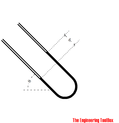

Inclined U-Tube Manometer
A common problem when measuring the pressure difference in low velocity systems - or systems with low density fluids - like air ventilation systems - are low column heights and accuracy. Accuracy can be improved by inclining the u-tube manometer.
The figure bellow indicates a u-tube where the left tube is connected to a higher pressure than the right tube. Note that the left and the right tube must in the same declined plane for the angle to the horizontal plane to be correct.
Inclined tube manometer
The pressure difference in a inclined u-tube manometer can be expressed as
pd = γ h sin(θ)                       (2)
h = length, difference in position of the liquid column along the tube (mm, ft)
θ = angle of column relative the horizontal plane (degrees)
Inclining the tube manometer increases the accuracy of the measurement.
Example - Differential Pressure Measurement with an Inclined U-Tube manometer
We use the same data as in the example above, except that the U-Tube is inclined 45o .
The pressure difference head can then be expressed as:
pd = (9.8 kN/m3) (103 N/kN) (10 mm) (10-3 m/mm) sin(45o)
= 69.3 N/m2(Pa)
