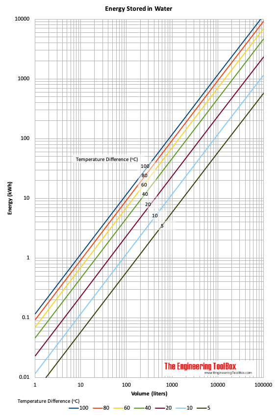

Water is often used to store thermal energy. Energy stored - or available - in hot water can be calculated
E = cp dt m                           (1)
E = energy (kJ, Btu)
cp = specific heat of water (kJ/kgoC, Btu/lboF) (4.2 kJ/kgoC, 1 Btu/lbmoF for water)
dt = temperature difference between the hot water and the surroundings (oC, oF))
m = mass of water (kg, lbm)
Example - Energy stored in a 1000 liter water tank
Water is heated to 90 oC. The surrounding temperature (where the energy can be transferred to) is 20 oC.
The energy stored in the water tank can be calculated as
E = (4.2 kJ/kgoC) ((90 oC) - (20 oC)) (1000 liter) (1 kg/liter)
    = 294000 kJ
    = (294000 kWs) (1/3600 h/s)
    = 81.7 kWh

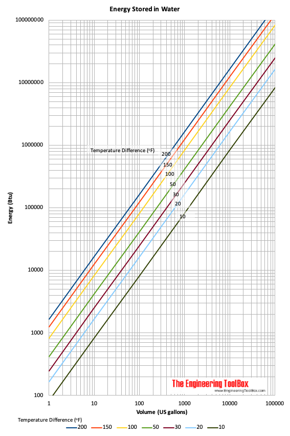

Example - Solar Energy stored in a 200 U.S. gallons Water Tank
A solar energy water buffer tank with 200 US gallons is heated 200 oF.
The solar energy stored can be calculated as
E = (1 Btu/lbmoF) (200 oF) (200 U.S. gallons) (8.3 lbm/US gallon)
    = 332000 Btu
