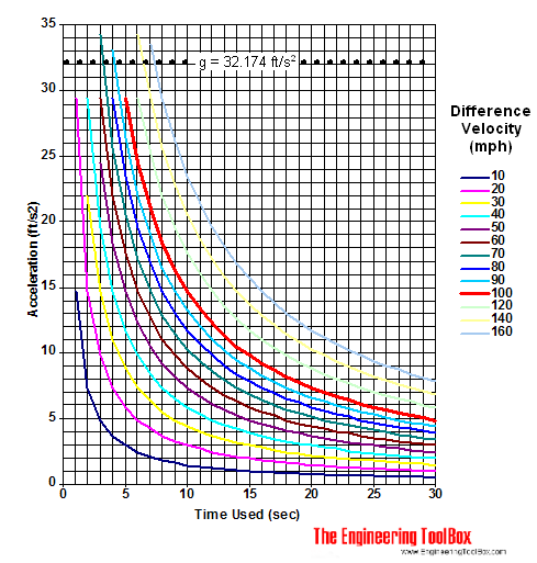

Car Acceleration Diagram - km/h
Download and Print Car Acceleration Chart
Car Acceleration Diagram - mph

Example - Car Acceleration
A car with mass 1000 kg (2205 lbm) accelerates from 0 m/s (0 ft/s) to 27.8 m/s (100 km/h, 91.1 ft/s, 62.1 mph) in 10 s .
The average acceleration can be calculated from eq. 1 as
a = ((27.8 m/s) - (0 m/s)) / (10 s)
= 2.78 m/s2
The average acceleration force can be calculated from eq. 3 as
F = (1000 kg) (2.78 m/s2)
= 2780 N
The distance moved can be calculated by rearranging eq. 2 to
ds = a dt2/ 2
= (2.78 m/s2) (10 s)2/ 2
= 139 m
The average acceleration work can be calculated from eq. 4 as
W = (2780 N) (139 m)
= 386420 J
The average acceleration power can be calculated from eq. 5 as
P = (386420 J) / (10 s)
= 38642 W
= 38.6 kW
