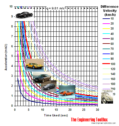

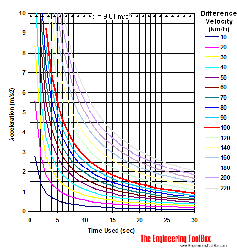

Car Acceleration Diagram - km/h
Acceleration of car diagram - km/h

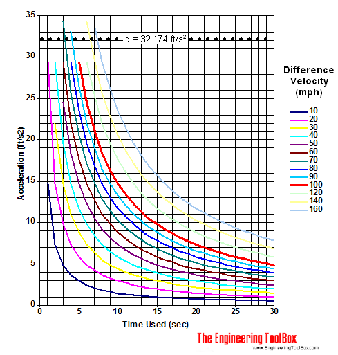

Car Acceleration Diagram - mph
Acceleration of car diagram - mph
