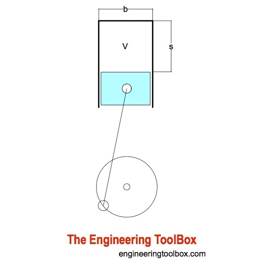

The displacement of a piston engine can be calculated as
V = (π / 4) s b2 noc             (1)
V = engine displacement (in3, cm3)
s = stroke (in, cm)
b = bore diameter (in, cm)
noc = number of cylinders
Example - Displacement of V8 Engine
The displacement of a 8 cylinder piston engine with stroke 3.31 in and bore 3.625 in can be calculated as
V = (π / 4) (3.31 in) (3.625 in)2 (8)
   = 273 cu in
