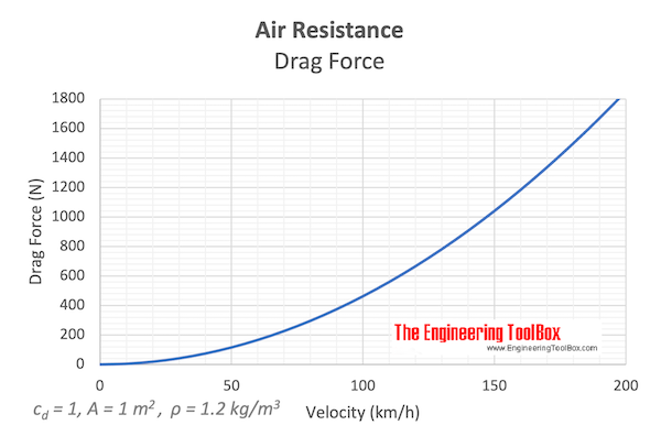

Air resistance - drag force - drag coefficient
Example - Air Resistance Force acting on a Normal Car
The force required to overcome air resistance for a normal family car with drag coefficient 0.29 and frontal area 2 m2 in 90 km/h can be calculated as:
Fd = 0.29 1/2 (1.2 kg/m3) ((90 km/h) (1000 m/km) / (3600 s/h))2 (2 m2
   = 217.5 N
The work done to overcome the air resistance in one hour driving (90 km) can be calculated as
Wd = (217.5 N) (90 km) (1000 m/km)
   = 19575000 (Nm, J)
The power required to overcome the air resistance when driving 90 km/h can be calculated as
Pd = (217.5 N) (90 km/h) (1000 m/km) (1/3600 h/s)
    = 5436 (Nm/s, J/s, W)
    = 5.4 (kW)
