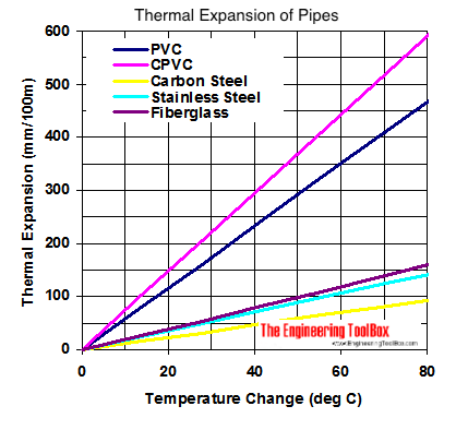

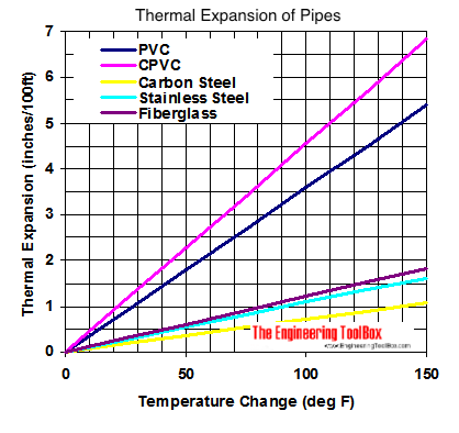

Thermal expansion of PVC, CPVC, Carbon and Stainless Steel and Fiberglass pipes.
Thermal expansion of pipes in PVC, CPVC, Fiberglass and Carbon or Stainless Steel in inches per 100 feet can be found in the diagrams and table below:
Pipes - thermal expansion diagram - fahrenheit
Pipes - thermal expansion diagram - celsius

1) Note the relative huge thermal expansion of thermoplastic plastic materials - like PVC and CPVC - compared to steel.
