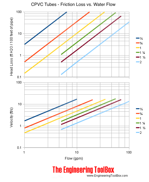

Head Loss (ft H2O/100 ft)
Head loss in CTS - Copper Tube Sized CPVC(Chlorinated Poly Vinyl Chloride) tubes:
CTS and CPVC pipe friction loss (ft h20) - flow (gpm) and velocity (ft/s)
  • 1 ft H2O = 0.4335 psi = 62.43 Lbs./Sq.Ft.
  • 1 gal (US)/min =6.30888×10-5 m3/s = 0.227 m3/h = 0.06309 dm3(litre)/s = 2.228×10-3 ft3/s = 0.1337 ft3/min = 0.8327 Imperial gal (UK)/min
  • 1 ft/s = 0.3048 m/s

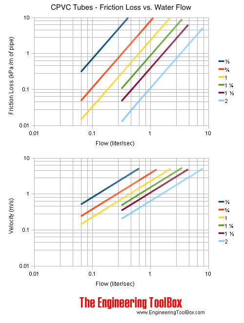

Pressure Loss (kPa/m)
Pressure loss in CTS - Copper Tube Sized CPVC(Chlorinated Poly Vinyl Chloride) tubes:
CTS and CPVC pipe friction loss (kPa) - flow (l/s) and velocity (m/s)
  • 1 Pa = 10-6 N/mm2 = 10-5 bar = 0.1020 kp/m2 = 1.02x10-4 m H2O = 9.869x10-6 atm = 1.45x10-4 psi (lbf/in2)
  • 1 dm3(litre)/s = 10-3 m3/s = 3.6 m3/h = 0.03532 ft3/s = 2.1189 ft3/min (cfm) = 13.200 Imp.gal (UK)/min = 15.852 gal (US)/min = 792 Imp. gal (UK)/h

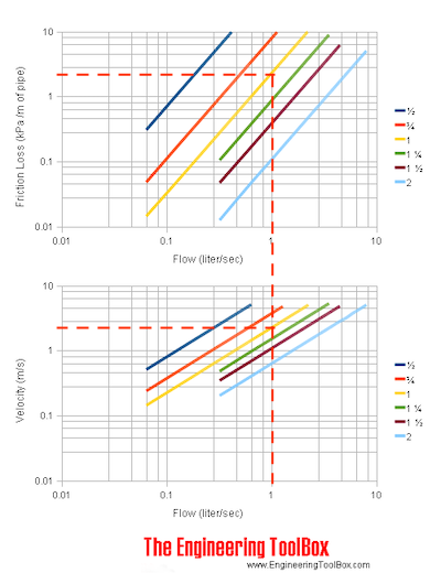

Example - Water Flow in Copper Tube
1 l/s of water flows through a 1" copper tube. From the figure below we estimates the velocity to be approximately 1.8 m/s and the pressure loss to be approximately 1.7 kPa/m.
CTS and CPVC pipe friction loss (kPa) - flow (l/s) and velocity (m/s) - example
