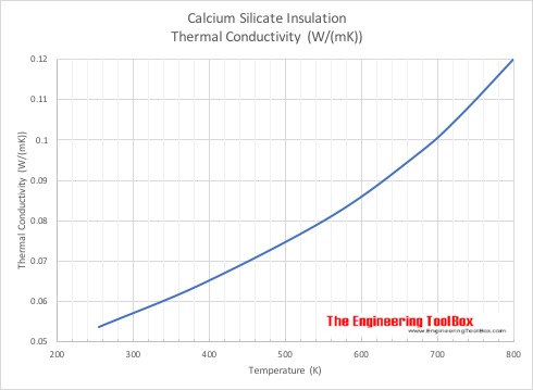

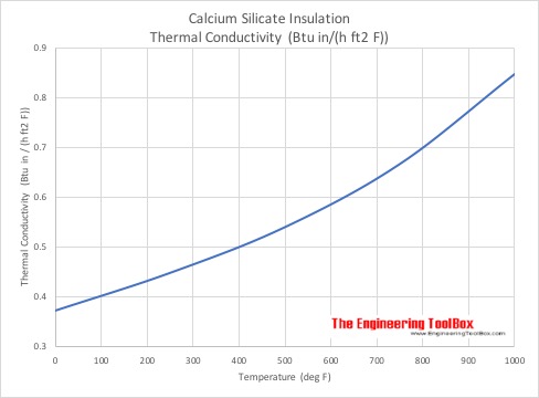

Calcium Silicate thermal conductivity related to temperature are indicated in the charts below:
Calcium silicate Themal conductivity - Metric units
Calcium silicate Themal conductivity - Imperial units
