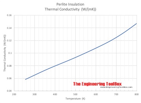

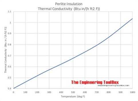

Thermal conductivity - k-values - vs. temperature.
Perlite is a type of volcanic glass that expands four to twenty times its original volume and becomes porous when heated. Perlite is suitable in high temperature applications.
Thermal conductivity vs. temperature are indicated in the charts below:
Perlite Insulation - Thermal Conductivity vs. Temperature - metric units
Perlite Insulation - Thermal Conductivity vs. Temperature - imperial units
  • tC = 5/9 (tF - 32)
  • 1 W/(m K) = 6.935 (Btu in)/(h ft² °F)
