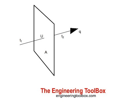

Heat transfer through a surface or wall
Heat transfer through a surface like a wall can be calculated as
q = U A dT                        (1)
q = heat transfer (W (J/s), Btu/h)
U = overall heat transfer coefficient (W/(m2K), Btu/(ft2 h oF))
A = wall area (m2, ft2)
dT = (t1 - t2)
     = temperature difference over wall (oC, oF)

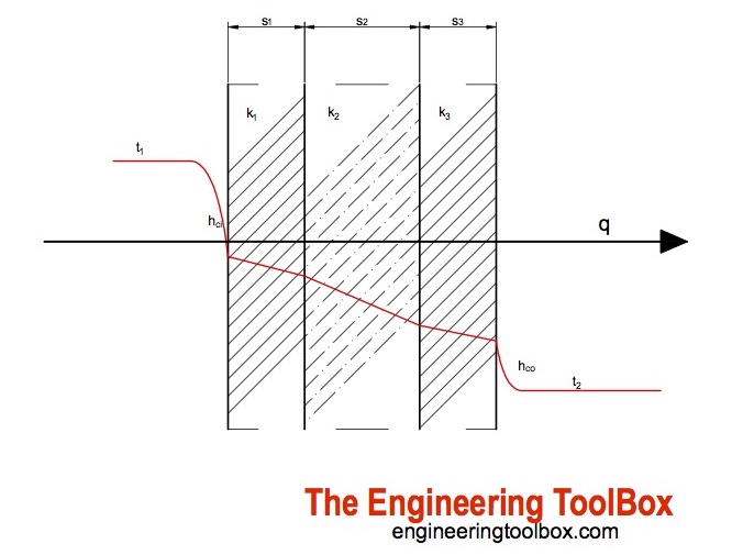

The overall heat transfer coefficient for a multi-layered wall, pipe or heat exchanger - with fluid flow on each side of the wall - can be calculated as
1 / U A = 1 / hci Ai + Σ (sn / kn An) + 1 / hco Ao                                      (2)
U = the overall heat transfer coefficient (W/(m2K), Btu/(ft2 h oF))
kn = thermal conductivity of material in layer n  (W/(m K), Btu/(hr ft °F))
hc i,o = inside or outside wall individual fluid convection heat transfer coefficient (W/(m2K), Btu/(ft2 h oF))
sn = thickness of layer n (m, ft)
A plane wall with equal area in all layers - can be simplified to
1 / U = 1 / hci + Σ (sn / kn) + 1 / hco                               (3)

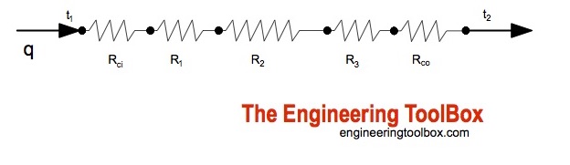

Heat Transfer Thermal Resistance
Heat transfer thermal resistance
Heat transfer resistance can be expressed as
R = 1 / U                               (4)
R = heat transfer resistance (m2K/W, ft2 h°F/ Btu)
The wall is split in sections of thermal resistance where
  • the heat transfer between the fluid and the wall is one resistance
  • the wall it self is one resistance
  • the transfer between the wall and the second fluid is a thermal resistance
