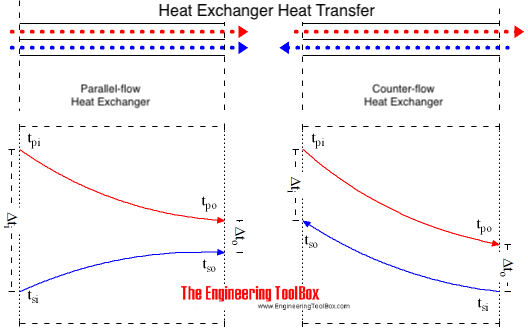

Mean Temperature Difference
The mean temperature difference in a heat transfer process depends on the direction of fluid flows involved in the process. The primary and secondary fluid in an heat exchanger process may
  • flow in the same direction - parallel flow or co-current flow
  • in the opposite direction - counter-current flow
  • or perpendicular to each other - cross flow
Logarithmic arithmetic mean temperature - difference lmtd amtd
With saturation steam as the primary fluid the primary temperature can be taken as a constant since the heat is transferred as a result of a change of phase only. The temperature profile in the primary fluid is not dependent on the direction of flow.
Logarithmic Mean Temperature Difference - LMTD
The rise in secondary temperature is non-linear and can best be represented by a logarithmic calculation. A logarithmic mean temperature difference is termed
  • LMTD (or DTLM) - Logarithmic Mean Temperature Difference
LMTD can be expressed as
LMTD = (dti - dto) / ln(dti / dto)                                       (1)
LMTD = Logarithmic Mean Temperature Difference (oF, oC)
For parallel flow:
dti = tpi - tsi = inlet primary and secondary fluid temperature difference (oF, oC)
dto = tpo - tso = outlet primary and secondary fluid temperature difference (oF, oC)
For counter flow:
dti = tpi - tso = inlet primary and outlet secondary fluid temperature difference (oF, oC)
dto = tpo - tsi = outlet primary and inlet secondary fluid temperature difference (oF, oC)
The Logarithmic Mean Temperature Difference is always less than the Arithmetic Mean Temperature Difference.

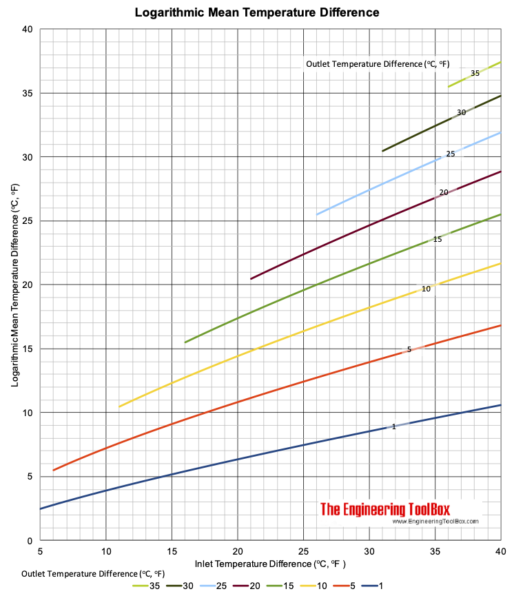

Logarithmic Mean Temperature Difference Chart
LMTD - Logarithmic mean temperature difference - chart
