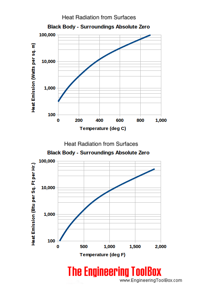

Heat transmission as radiation from a black body to surroundings with temperature absolute zero
Example - Heat Radiation from the surface of the Sun
If the surface temperature of the sun is 5800 K and if we assume that the sun can be regarded as a black body the radiation energy per unit area can be expressed by modifying (1) to
q / A = σ T4
    = (5.6703×10-8 W/m2K4) (5800 K)4
    = 6.42 107 (W/m2

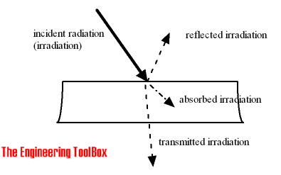

For the gray body the incident radiation (also called irradiation) is partly reflected, absorbed or transmitted.
Heat radiation - incident reflected transmitted absorbed irradiation
The emissivity coefficient is in the range 0 < ε < 1, depending on the type of material and the temperature of the surface.

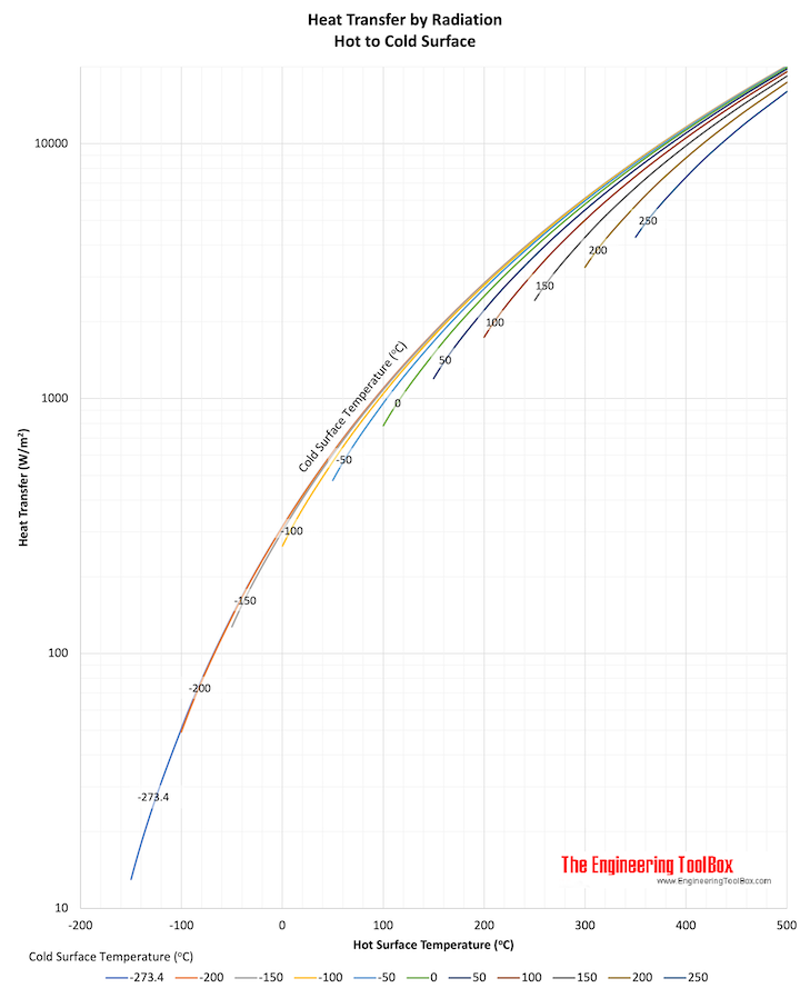

Net Radiation Loss Rate
If an hot object is radiating energy to its cooler surroundings the net radiation heat loss rate can be expressed as
q = ε σ (Th4 - Tc4) Ah                                    (3)
Th= hot body absolute temperature (K)
Tc= cold surroundings absolute temperature (K)
Ah = area of the hot object  (m2)
Heat loss from a heated surface to unheated surroundings with mean radiant temperatures are indicated in the chart below.
Heat transfer - radiation from hot to cold surface
Download and print Heat Transfer by Radiation chart
Radiation Heat Transfer Calculator
This calculator is based on equation (3) and can be used to calculate the heat radiation from a warm object to colder surroundings.
Note that the input temperatures are in degrees Celsius.
