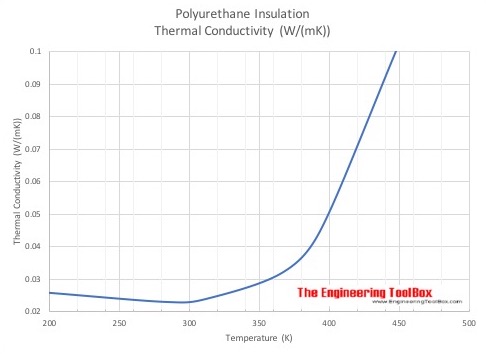

Thermal conductivity vs. temperature are indicated in the charts below:
Polyurethane Insulation - Thermal Conductivity - Metric Units

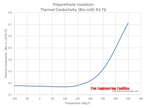

Polyurethane Insulation - Thermal Conductivity - Imperial Units
  • T (oC) = 5/9 (T (oF) - 32)
  • 1 W/(m K) = 6.935 (Btu in)/(h ft² °F)
