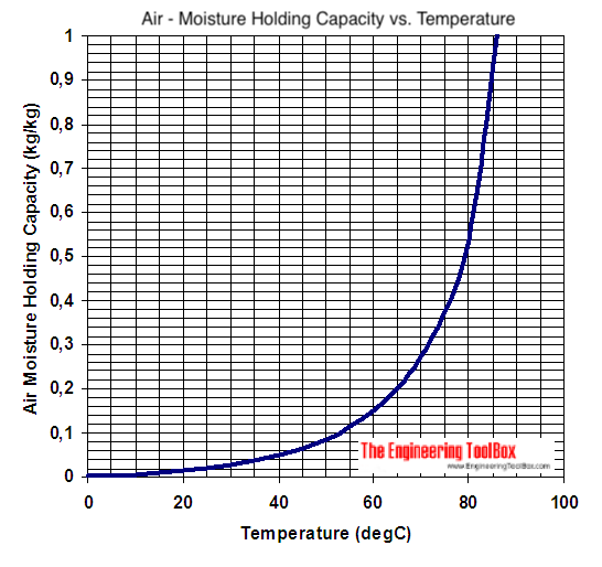

Air Moisture Holding Capacity - SI Units
Moisture holding capacity of air - kg water per kg dry air:

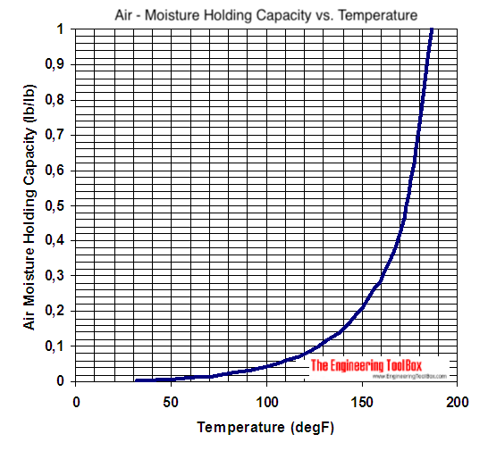

Air Moisture Holding Capacity - Imperial Units
Moisture holding capacity of air - lb water per lb dry air:

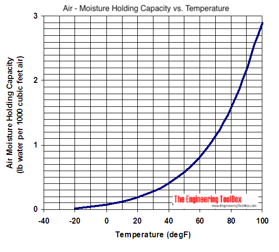

Moisture holding capacity of air - lb water per 1000 cubic feet dry air:
Note - the moisture holding capacity of air at 100oF (38 oC) is 10 times the moisture holding capacity of air at 30oF (~ 0 oC). This is a very important observation - especially when working with drying processes where air is used to transport moisture away from process and products.
In general
- it is in general good energy economy to increase the air temperature in a dryer as much as possible! - the increased moisture transport capacity of air at higher temperature out-weights the increased energy-consumption for heating the dry air to higher temperature!
