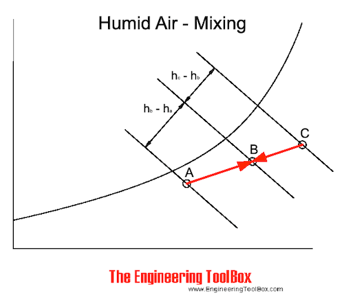

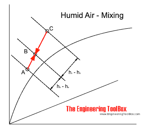

In the Mollier diagram - or in the psychrometric chart - when mixing air of state A and C, the mixing point will be on a straight line in point B.
The position of point B depends on the air volume (or mass) of the air in state A and C.
Moist air - change of state by mixing air - Mollier diagram
The mixing process are indicated in a Mollier diagram above and in a psychrometric chart below.
Moist air - change of state by mixing air - Psychrometric diagram
Enthalpy Balance when Mixing Air
The heat or enthalphy balance when humid air is mixed can be expressed as:
QA hA + QC hC = (QA + QC) hB                                   (1)
Q = volume of the air (m3)
h = enthalpy of the humid air (kJ/m3)
By transforming (1) the enthalpy of the mixed air can be expressed as:
hB = (QA hA + QC hC) / (QA + QC)                                      (1b)

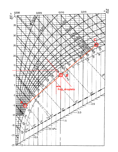

Mixing Point is below Saturation Line
If the mixing point is below the saturation line - water is condensed as droplets and fog is created.
The amount of condense water can be estimated by following the constant enthalpy line from B to the saturation line. The condensate water is the difference between the specific humidity in point B and in the point where the enthalpy line crosses the saturation line.
The mixed temperature is where the enthalpy line crosses the saturation line.

The Mixing Point is below the Saturation Line
1 m3 of air at 25oC and 90% relative humidity (C) is mixed with 1 m3 air at -5oC and 80% relative humidity (A).
From the Mollier diagram the humidity ratio of (C) is 0.018 kg/kg. The enthalpy is 70 kJ/kg. The humidity ratio of (A) is 0.002 kg/kg. The enthalpy is 0 kJ/kg.
The enthalpy of the mixture can be calculated as:
hB = ((1 kg) (0 kJ/kg) + (1 kg) (70 kJ/kg)) / ((1 kg) + (1 kg))
= 35 kJ/kg
The humidity ratio of the mixture can be calculated as:
xB = ((1 kg) (0.002 kg/kg) + (1 kg) (0.018 kg/kg)) / ((1 kg) + (1 kg))
= 0.01 kg/kg
Note! This is the humidity ratio including the water droplets - the fog.
The "virtual" mixing point in the Mollier diagram is where the enthalpy line - 35 kJ/kg and the humidity ratio line - 0.01 kg/kg - intersect.
The temperature in the mixed air can be found in the diagram where the enthalpy line - 35 kJ/kg - crosses the saturation line. From the Mollier diagram the mixed temperature is approximately 12.7 oC.
According the Mollier diagram the moisture ratio at this point is approximately  0.0089 kg/kg. The moisture created as fog or droplets is
(0.01 kg/kg) - (0.0089 kg/kg)
    = 0.0011 kg/kg
Moist air - mixing air and creating fog - Mollier diagrams
