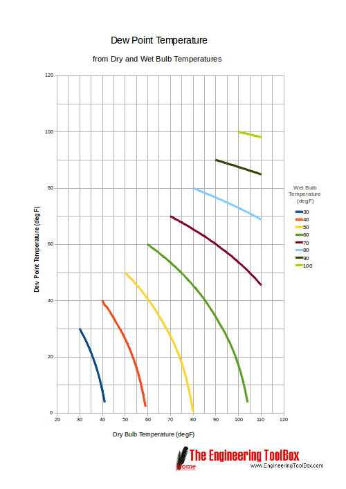

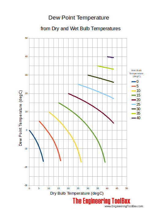

Dew Point Temperature Charts
Dew point temperatures from dry and wet bulb temperatures are indicated in the charts below.

Dew Point Temperature Chart - Celcius
Dew Point Temperature Chart - Fahrenheit
