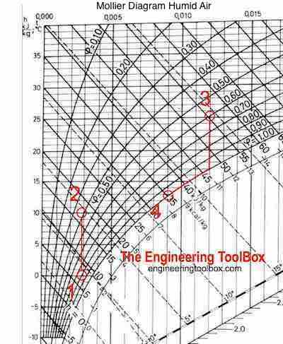

Heating Process - Recovery without Moisture Transfer
The heating process without moisture transfer with a recovery unit - typical like the cross flow unit in the figure above - can be visualized in a psychrometric Mollier diagram as
Mollier diagram - Heating process without moisture transfer

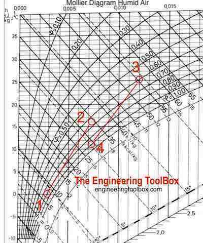

Heating Process - Recovery with Moisture Transfer
The heating process with moisture transfer and a recovery unit - typical like the rotating wheel unit in the figure above - can be visualized in a psychrometric Mollier diagram as
Psychrometric Mollier diagram - Heat recovery with moisture transfer
