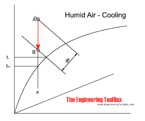

Cooling Moist Air - Sensible Cooling
If the temperature on a cooling surface - tC - is above or equal to the dew point temperature - tDP - of the surrounding air, the air will be cooled without any change in specific humidity. It is Sensible Heat - the "temperature heat" - in the air that is removed.
The air cools along a constant specific humidity - x - line as indicated in the Mollier diagram below:
Moist air - cooling
The process is very similar (opposite direction) to the sensible heating process and the heating formulas can be adapted to calculate change in enthalpy and temperature.
Note! The specific humidity is constant but the relative humidity will increase.

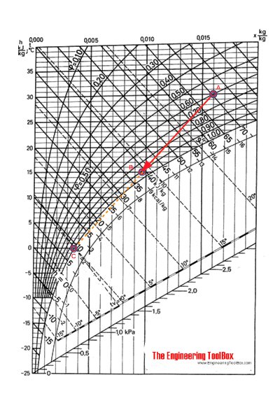

Example - Cooling and Dehumidifying Air
1 m3/s of air at 30 oC (86 oF) and relative humidity 60% (A) is cooled down to 15 oC (59 oF) (B). The surface temperature of the cooling coil is 0 oC (32 oF) (C). The density of the air at 20 oC is 1.205 kg/m3.
In the Mollier diagram the state of the cooled air (B) is in the intersection between the straight line between (A) and (C) and the 15 oC temperature line.
Moist air - Mollier chart - cooling and dehumidifying air
From the Mollier diagram it can be stated that the enthalpy in (A) is 70 kJ/kg, in (B) 38.5 kJ/kg and in (C) 8.5 kJ/kg.
The Contact Factor can be calculated as
β = ((70 kJ/kg) - (38.5 kJ/kg)) / ((70 kJ/kg) - (8.5 kJ/kg))
= 0.51
The total heat flow can be calculated as
q = (1 m3/s) (1.205 kg/m3) ((70 kJ/kg) - (38.5 kJ/kg))
= 38 (kJ/s, kW)
The sensible heat flow can be calculated as
qs = (1 m3/s) (1.205 kg/m3) (1.01 kJ/kg.oC) (30oC - 15oC)
= 18.3 (kW)
According the Mollier diagram the specific humidity in (A) is 0.016 kg/kg and in (B) 0.0096 kg/kg and the latent heat flow can be calculated as
qs = (1 m3/s) (1.205 kg/m3) (2502 kJ/kg) ((0.016 kg/kg) - (0.0096 kg/kg))
= 19.3 (kW)
Note! Due to inaccuracies when working with graphical diagrams there is a small difference between the total heat flow and the sum of the latent and sensible heat. Inaccuracies like this are in general within acceptable limits.

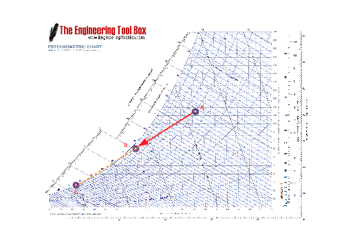

A similar cooling and dehumidifying process in the psychrometric chart:
Moist air - psychrometric chart - cooling and dehumidifying air
