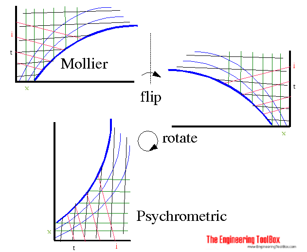

A Mollier diagram express the same psychrometric properties as a psychrometric chart. Both presentations are very useful when designing air condition systems, drying processes etc.
The process of transforming a Mollier diagram to a psychrometric chart - or vice versa - is shown below.
  • first - it has to be reflected - flipped - in a vertical mirror
  • second - it must be rotated 90 degrees
Transforming Mollier diagram to psychrometric chart - and vice verca
