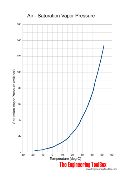

Air - water saturation vapor pressure diagram
If the water vapor pressure in the air is 10.3 mbar, the vapor saturates on a surface with 45oF (7oC).
Note! The atmospheric pressure of air is 1013 mbar (101.325 kPa, 760 mmHg). As we can see the maximum water vapor pressure - the saturation pressure - is relatively small.

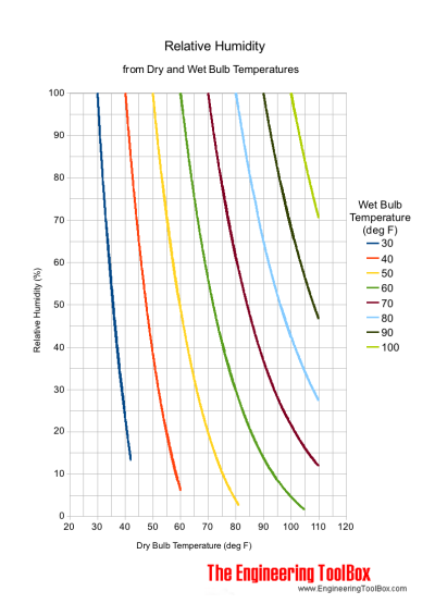

Relative Humidity Chart - degrees Fahrenheit
Moist air - relative humidity versus dry and wet bulb temperatures

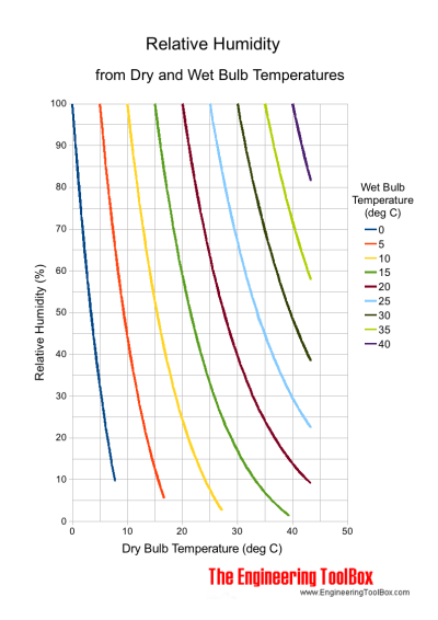

Relative Humidity Chart - degrees Celsius
